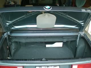

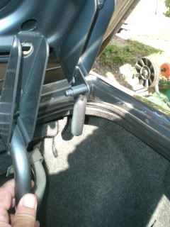

    I have already primed and painted my 'new' passenger side hinge and installed it. Photo for comparison:

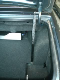

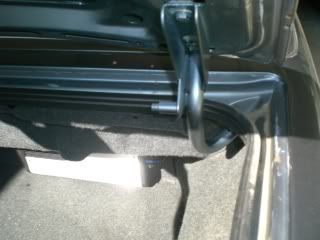

    Once you get the trunk re-aligned and tighten all the screws, you will install the later model struts. There is a convenient tab for mounting the bottom of the strut. I simply drilled and bolted the lower strut to this tab.
    Close-up:

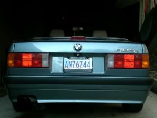

    Pic of it completed:
    Nice to have one-touch opening of my trunk lid without the raised edge:

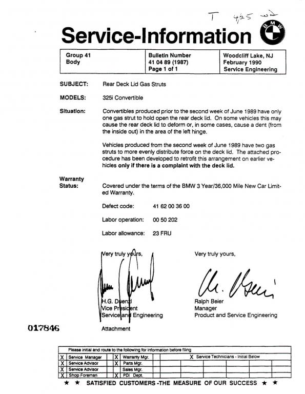

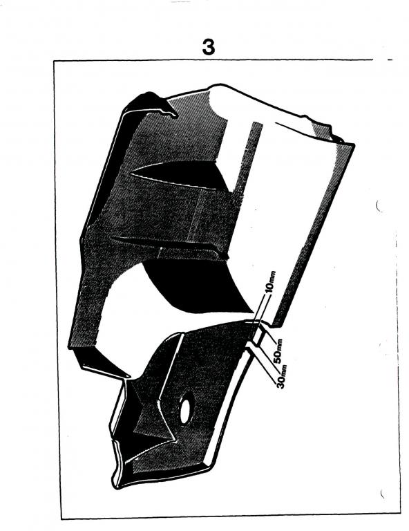

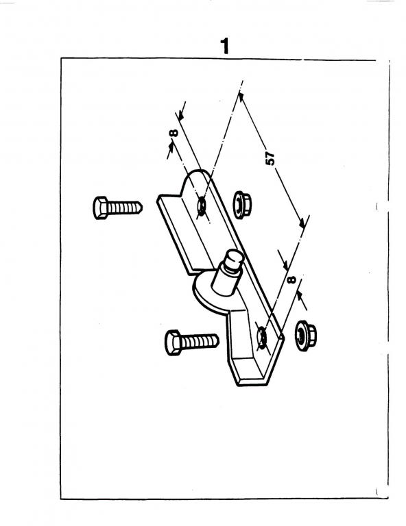

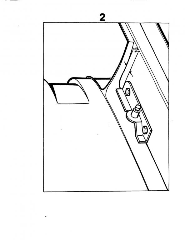

          another solution
          Cool! Easy. I have attached another way - from a BMW tech bulletin.

            I wonder if anyone ever was able to get their trunk lid fixed under this service bulletin?
