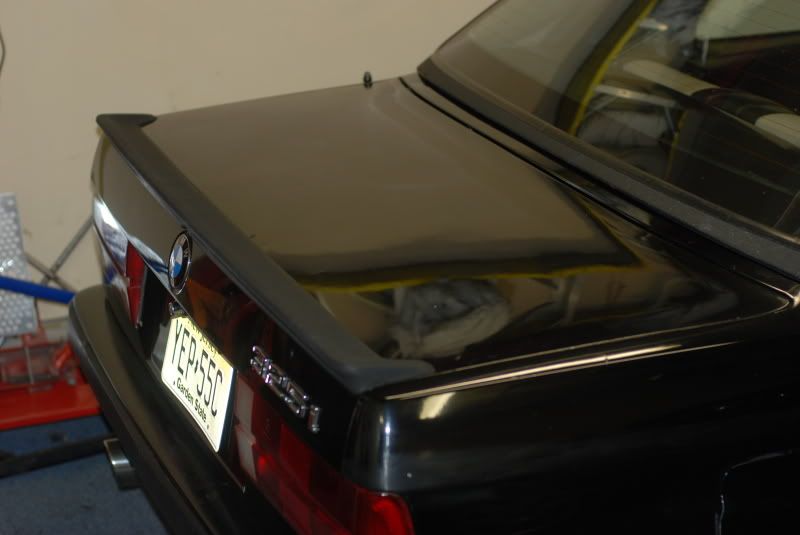

Ask and you shall recieve...I'll take some outside in the morning.
The 3rd brake light delete with is lip...
OH...and I figured out the wires that need to be jumped to kill the brake check light.
There are 4 wires in the 3rd brake light harness...the brown (ground) and the red with green stripe. The other two green wires are the ones that need to be jumpered.
I'm happy for now...:D
