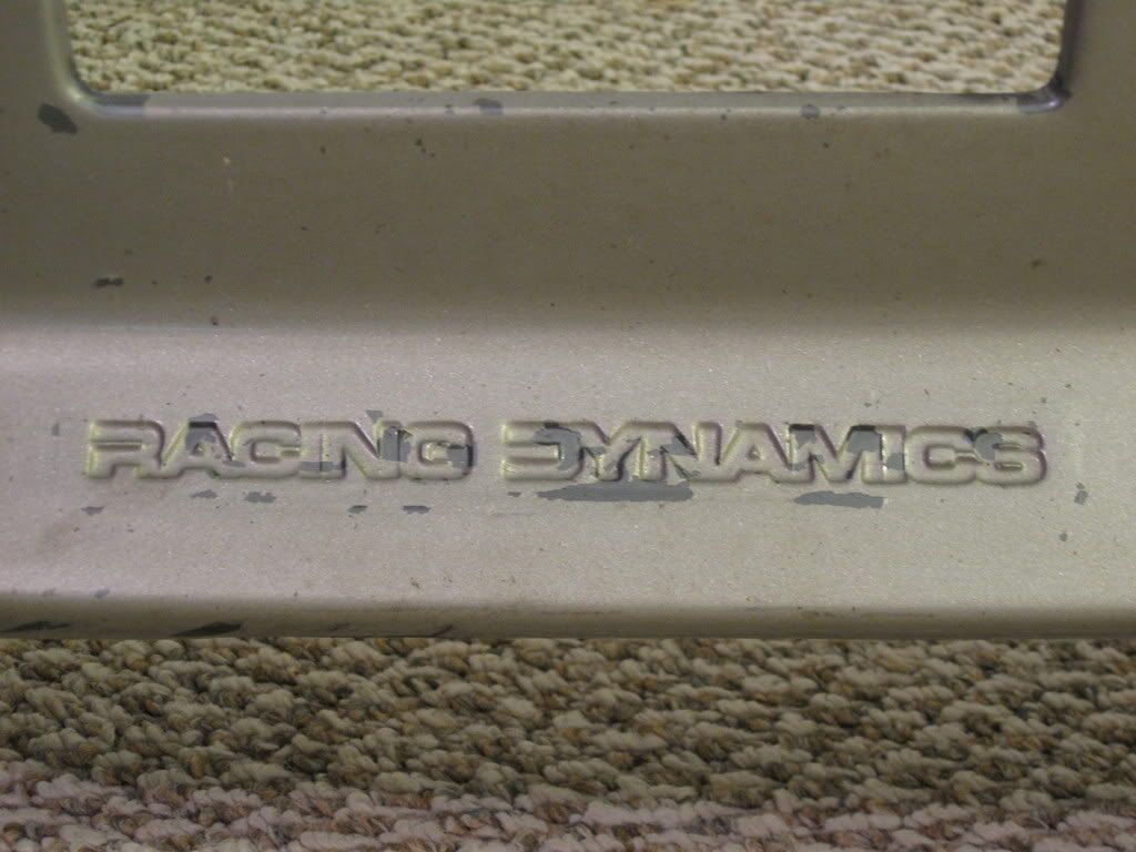

    Fogs for this front valence? (Older Racing Dynamics)
    Can anybody confirm what fogs will fit with this valence? I just picked it up, a few people I know have suggested E30 M3s...but aren't positive.
    I can't seem to find much information on this anywhere...only found a few people on here who have this one.

    I can measure mine and try to get a p/n.
    Does yours still have the brackets attached?

      They looks like the one from a mtech1...?...

        Is it meant for diving board cars? It looks like it needs the fogs for the '86 325es or '87 325is. I believe these are the same as M3.

          Those holes look bigger than the early fogs for euro valance / m3s. Early fogs =! m3 fogs, it's the early euro fogs that = e30m3 fogs.
          I think it needs regular early e30 fogs, but you would want to measure...

            E28, not positive but it looks like it will work.

              Its meant for diving boards.. the holes are a good bit bigger it seems than the fogs I have on my 87 325.

                  The face of the lamp measures just over 7"x3"
                  The set I have say "rechts" on the light housing, have zkw lenses that say "B (e12) 19022" across the face and "491.01" in the lower right hand corner and the brackets are hella p/n 123 509.
                  I hope that is somehow helpful.
                  Did you try contacting RD for a replacement set of lights? They still sell the spoiler.

                    I'm waiting to hear back from RD.

                      Alright, RD came back with these part numbers from Euro E28s (according to realOEM)...any idea where I might find these?

                        Oh nice, very obscure. You can probably still order them new though...
                        • Aptyp
                          • 6584
                          Hella 530......
                          http://cgi.ebay.com/ebaymotors/Hella...QQcmdZViewItem

                            Looks like those should fit just about perfectly.
