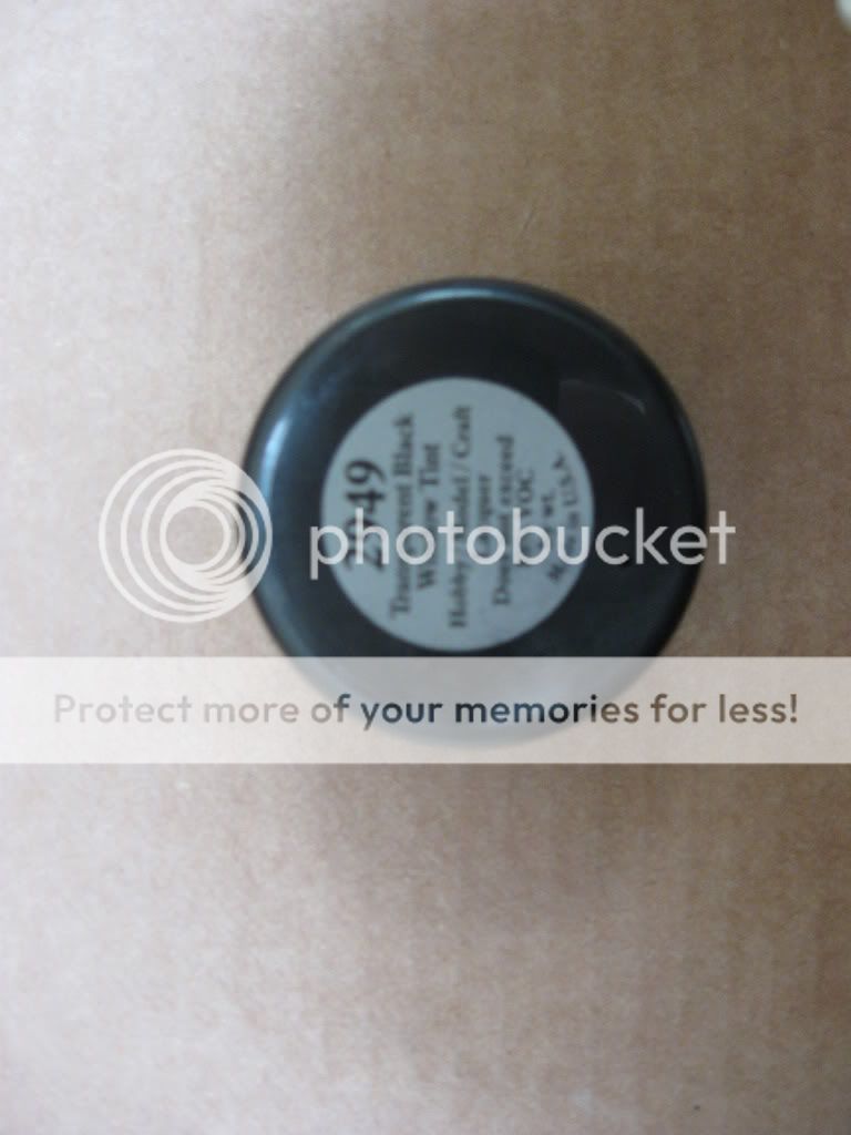

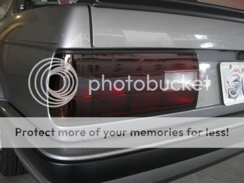

            okay, what i do is mix black paint with clear coat, and spray, mines held up for about a year, I wax them and polish them every once and a while.
            cars dirty in the pic, it only cost about $10 worth of materials and they are holding up great
            it was raining
            7speedshop.com
              Slangbox and TDe30 thanks for those links.
              and Kamators, that looks pretty good, what type of black paint and clear coat are you using? I also have a brilliantrot and I really like the smoked tails on it

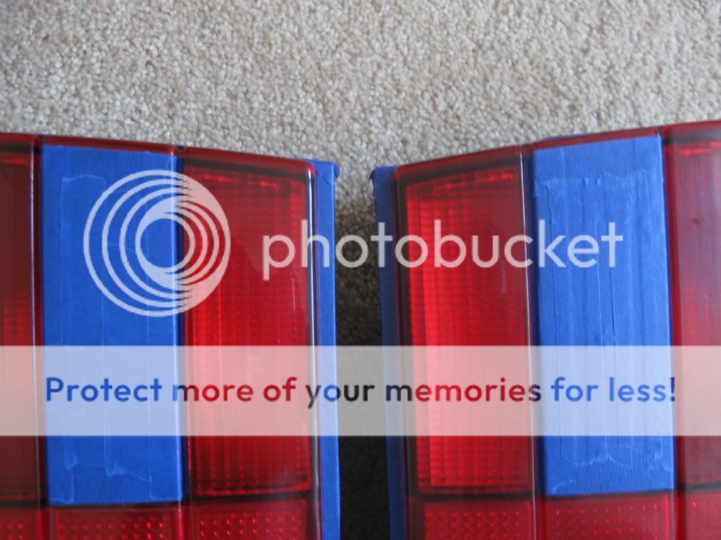

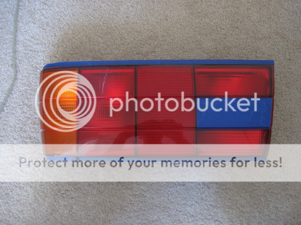

                          Originally posted by Uber E30
                          Ok so i pulled them off today and got the smoke on there, they are going to the body shop tomorrow for a coat of clear. Im pretty pleased with the results so far. I tried to stay as close to the MHW look as possible so i masked off the reverse lights. Im hoping they will really pop once i pull the tape off. More pics to come once i get them from the body shop and installed on my car.
                          One down
                          Masked off clear part, took lotsa care in making the lines straight.
                          Masking of the trim
                          More trim +clears
                          2 Down
                          MM Translucent Black
                          After the spray
                          Amber?
                          Clears

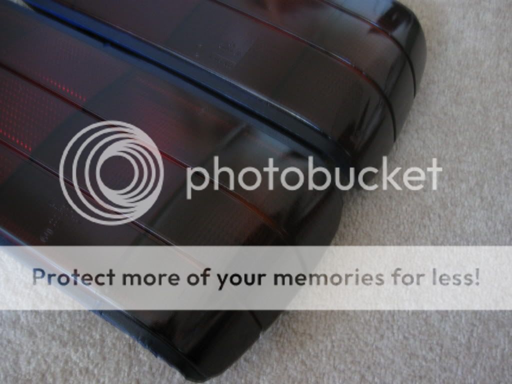

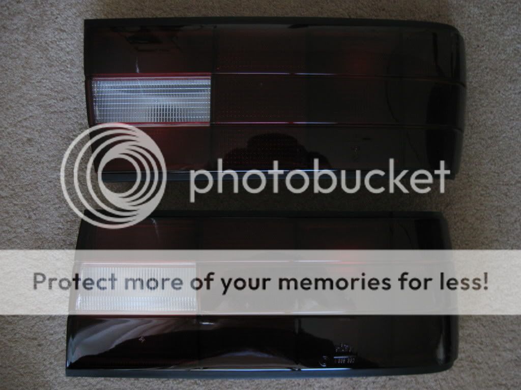

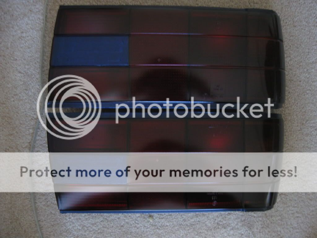

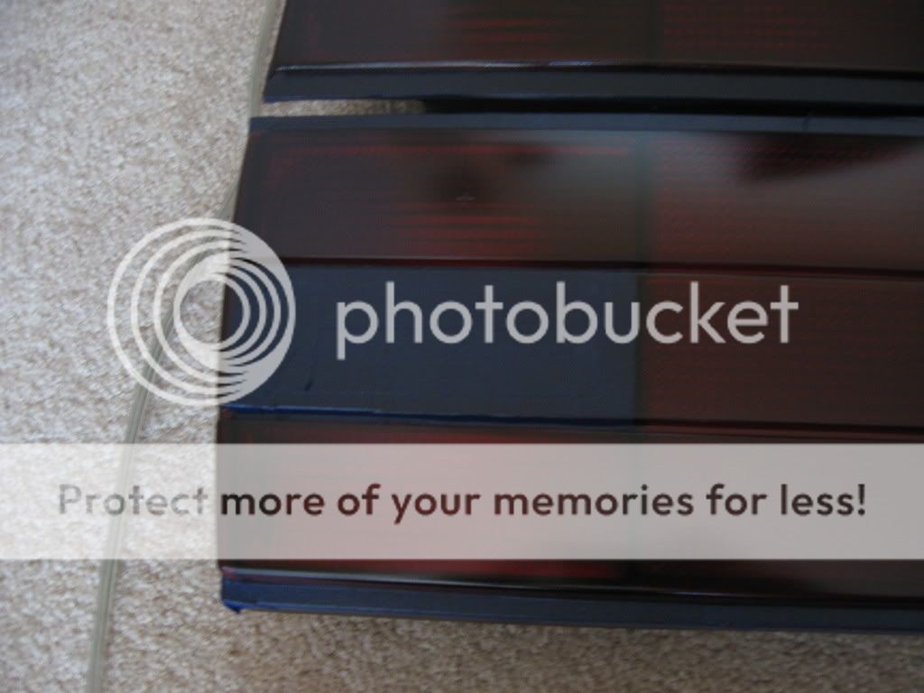

                          Got the tails back today they turned out great. Here are some pics
                          fresh from the shop
                          Looks good
                          Left
                          Right
                          Nice and glassy, you can see the bushes and the apartment next door in them
