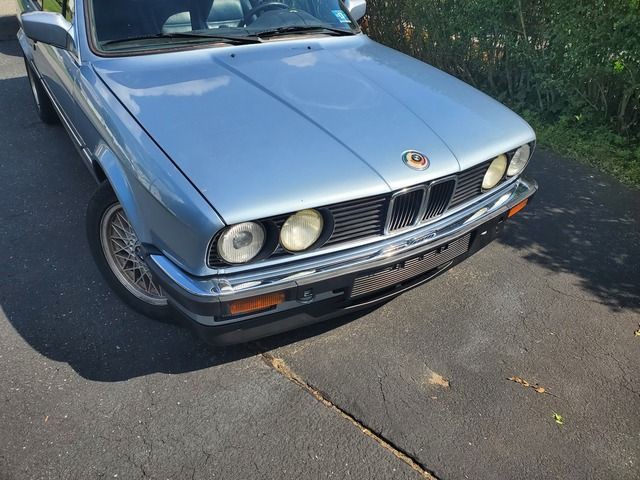

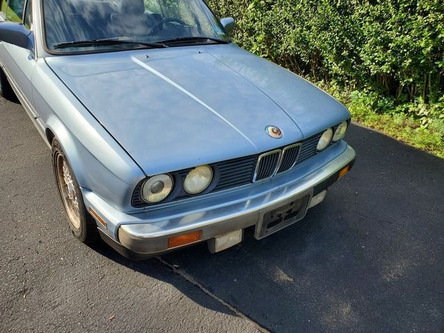

    So, I have been wanting to install euro bumpers on my '90 vert for a while.
    I got a great set and tackled the front bumper last weekend. While the bumper itself was straightforward, the valance was a bitch of a fit!!! On the whole, I am ecstatic with the results. It's not 100% perfect, but I don't think anyone could do better. I think I know every part of the front bumper and valance now as I have had it on and off so many times for adjustments!! I think this changes the look of the car more than anything else I've done!
    Before:
    And......after:
