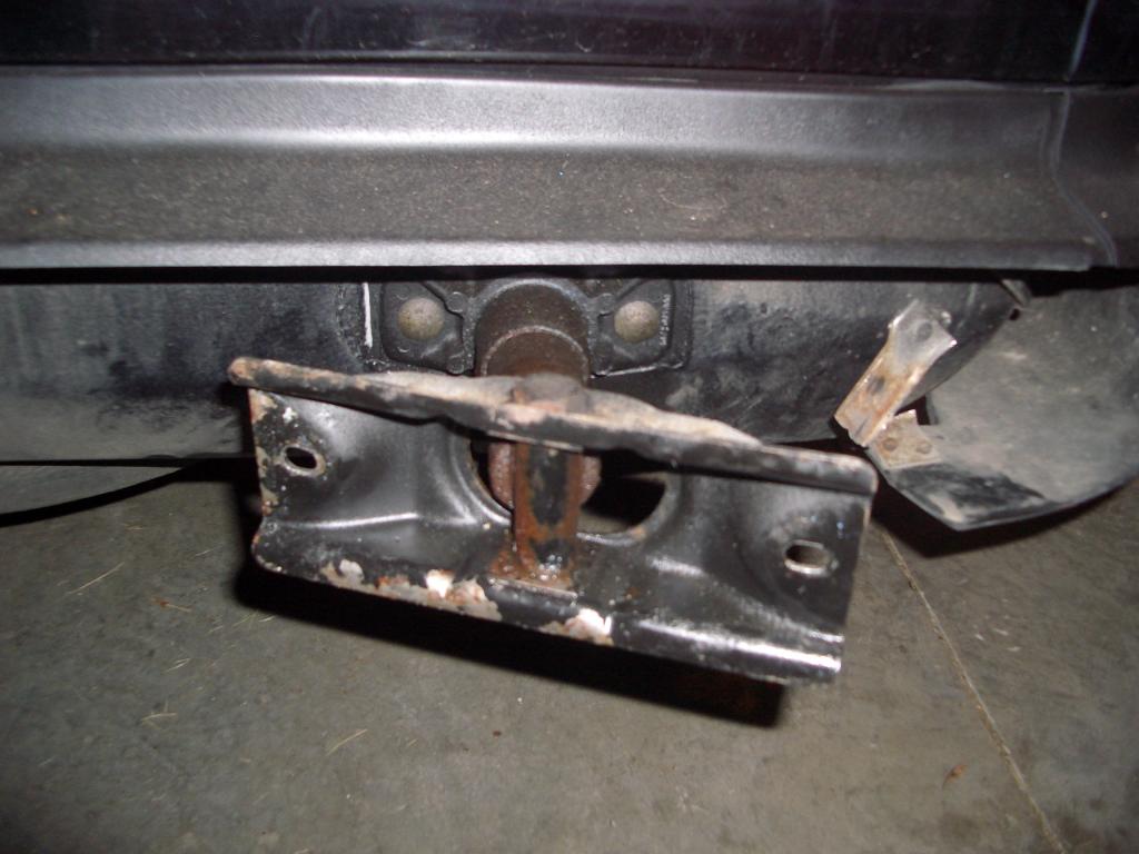

                      here are some pics, and a couple of my project...just got the seats redone, next is all body work and cosmetics.

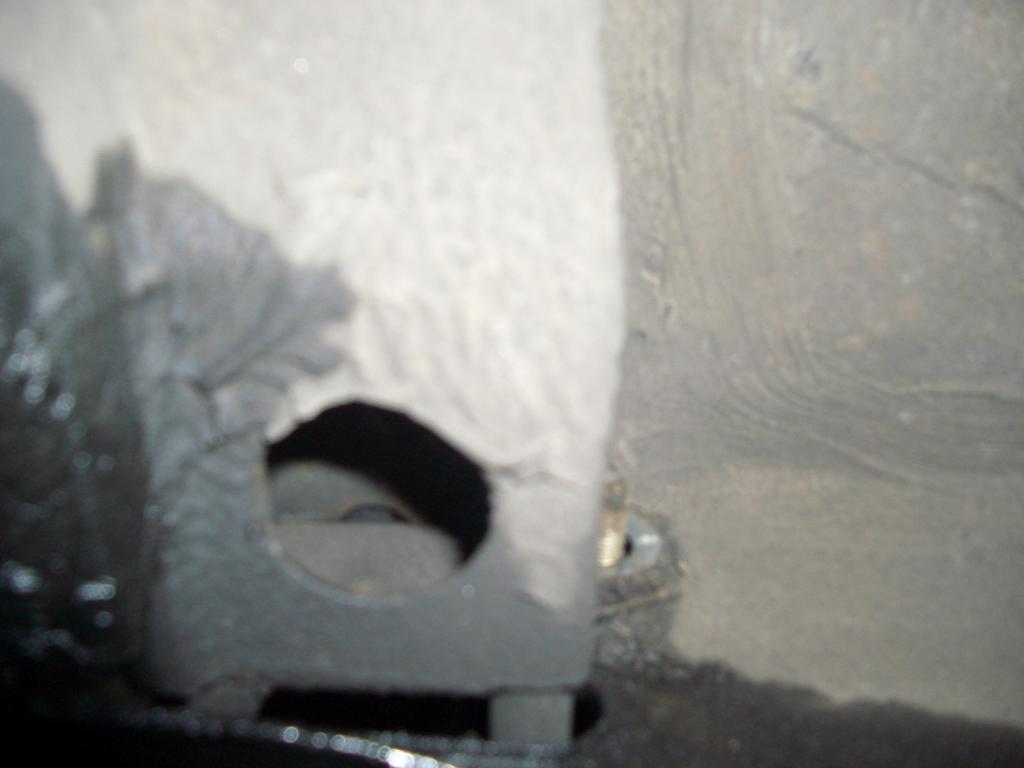

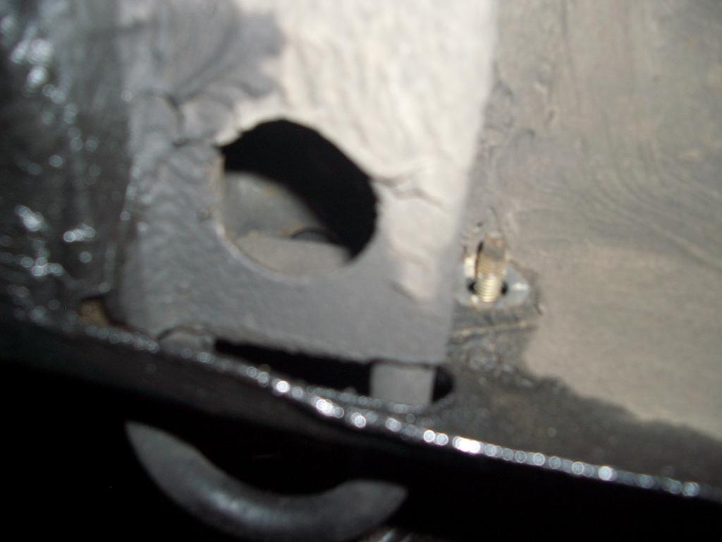

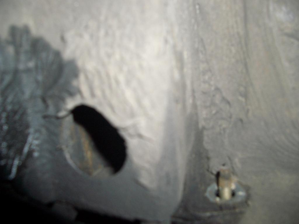

                              i found both of the frame rail bolts, i still haven't had any luck locating the right bolt on the right side. where the bolt goes in, there is a shroud or something, but it is welded on there....if you look at pic 4, you'll see what i am talking about.
