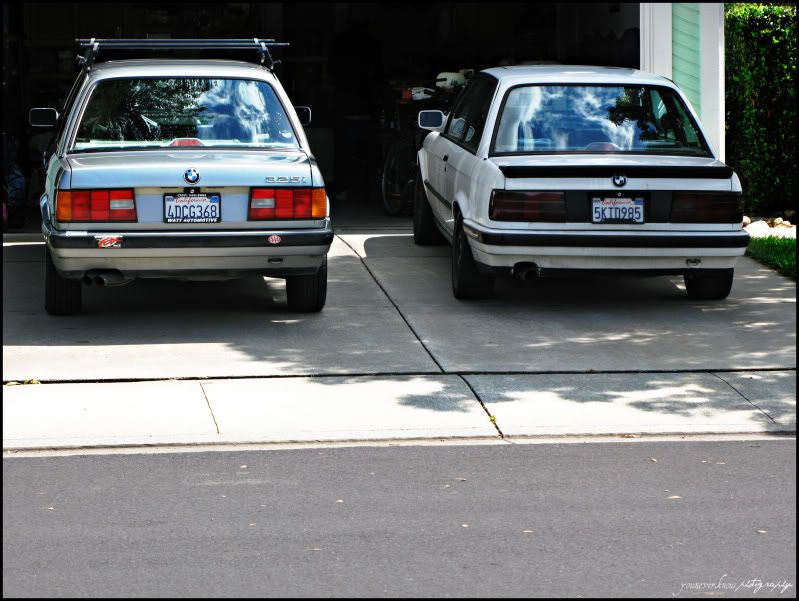

                I have an e28 mtech spoiler.
                I'll see if I can find a picture of my car that shows it well vs an e30 spoiler.
                • Danny
                  • 14217
                  You can see here the e28 spoiler hangs onto the quarter panel.
                  And the E30 one does not.
