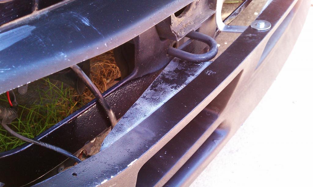

    I'm having an issue installing the es valence I recently bought. My car is originally a straight 1987 325. Is the metal valence different between the models? It seems lime it is too short. It falls like an inch + in front of the curvature of the wheel area. The cutout for the fogs is resting straight against the metal of the valence. Any thoughts?

          I am using stock mounting locations, but i had to make my own brackets. These are not the issue though. The valence is physically touching the sheetmetal, but short on the sides. The cutouts for the fogs dont line up between the plastic and sheetmetal. Like the fogs are resting against the aheetmetal, not fitting through it. Ill post a pic when i get home. I wonder if someone put an older piece of sheetmetal on the car?

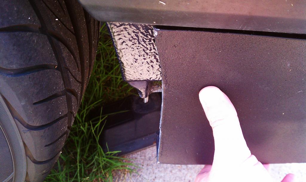

            See attached.
            Notice in the 1st shot how the protrusion for the fog on the plastic valence hits the metal?

              It looks like someone possibly cut the sides of the valance

                Yep, the sides have been trimmed short.

                  Yeah. I sorta figured that. Probably mounted on an earlier car as I understsand their dimensions were a bit different. Awesome. *sigh* Guess I will be making something. Anyone good with fiberglass? :D
