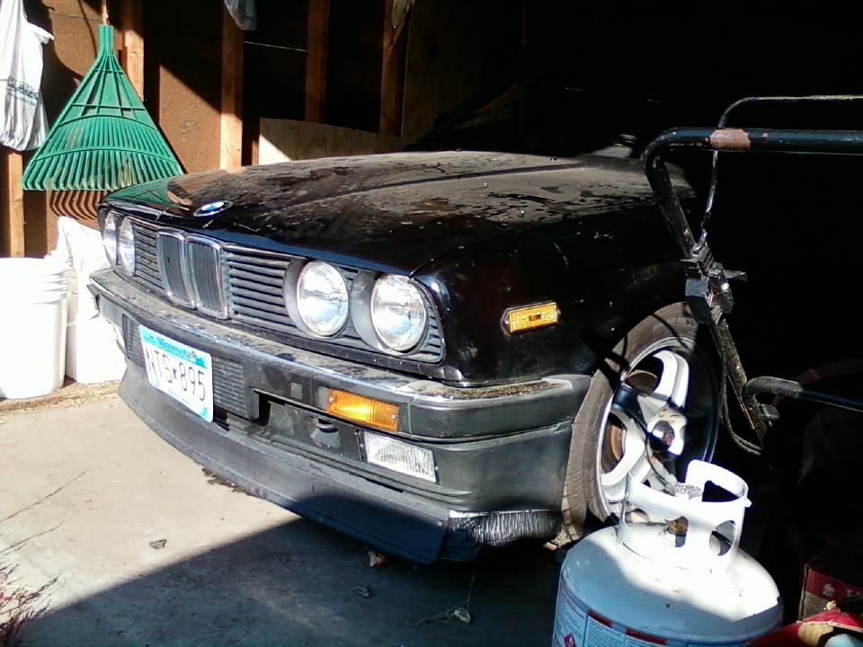

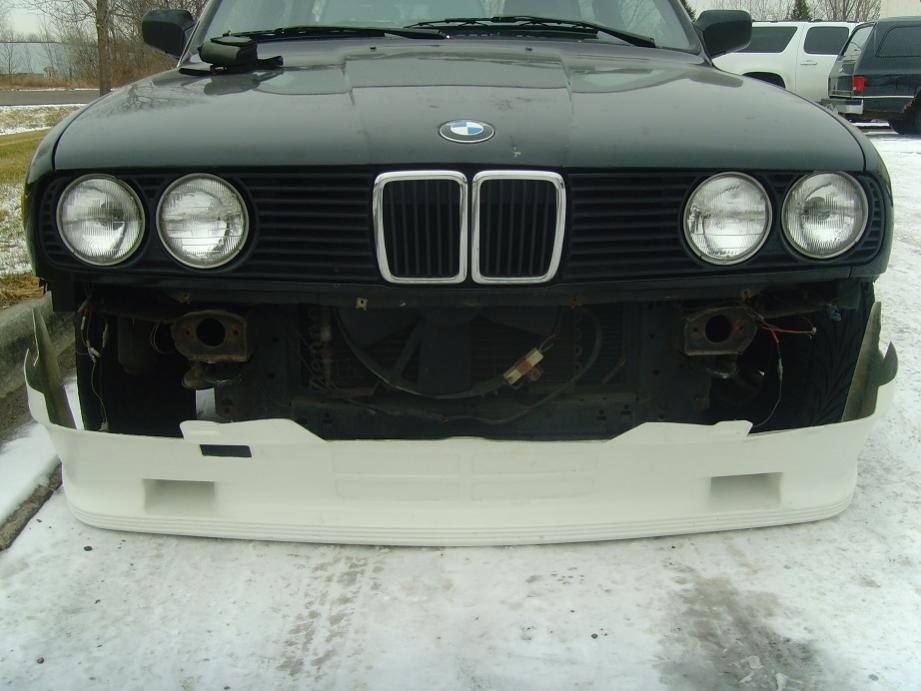

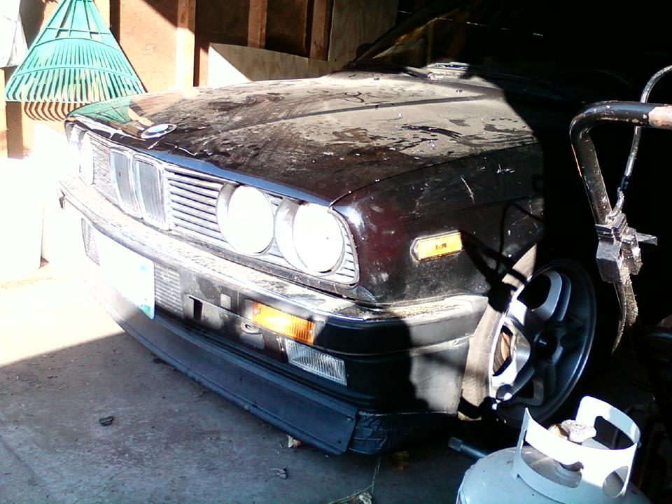

    Alright I have a question for you guys, the guy who's installing my new front Mtech1 apron just called me and told me that the Euro Mtech apron doesn't fit my car. I drive an 1983 323i Euro, I can also give VIN# but only if needed. Is an 83 considered an "early E30", it surely look like one??? I thought it was considered as an early E30 so I purchased the apron. The picture below shows the current beatup bumper, I think the apron is a an old Zander apron for the early E30s with a euro bumper.
    My bodytech told me that the new Mtech1 apron wider by a few inches and longer on the sides by also a few inches. He said that inorder for it to fit, he would have to cut it.
    Any help will be good. Thanks.

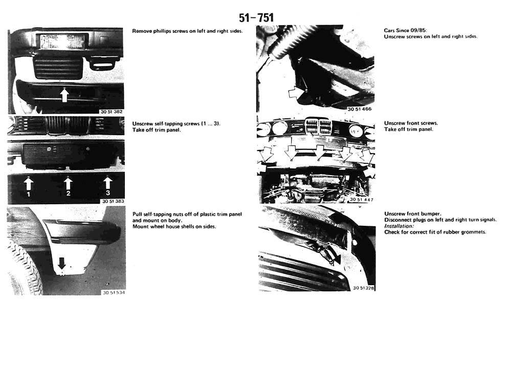

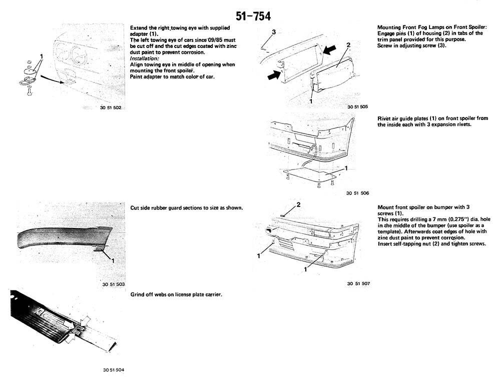

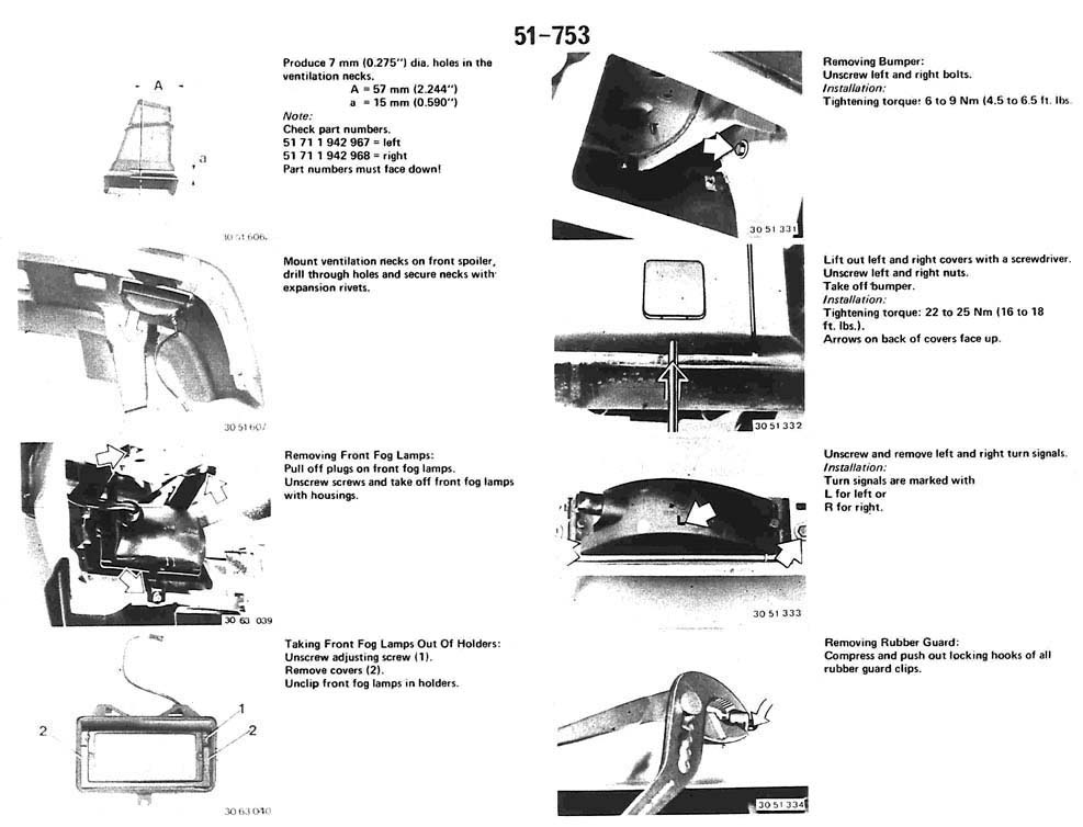

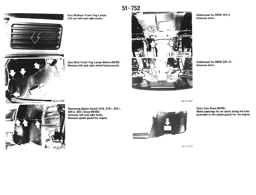

    My guess would be your bodyman doesn't know how the m-tech 1 spoiler mounts and is trying to fit it the same way your zender spoiler is attached. Unlike the Zender spoiler the m-tech 1 spoiler attaches to the outside of the bumper. It sandwiches between the bumper and black bumper molding.
    See the attached pics for some installation instructions. The instructions are not the most in depth but better than nothing.
    You should check out Realoem.com as well so you can get the part numbers for the correct hardware, otherwise your "bodyman" will probably just use drywall screws

                      I was looking through td325ic directions he put up and it shows what to cut on the trim.

                        Can you get a photo showing exactly how it's not fitting? Your bodyman said it's a few inches longer and a few inches deeper, right? Even a fiberglass replica spoiler from DTMfiberwerkz is not going to be that far off. They make some questionable parts now and then but to be off by a few inches I have a hard time believing especially when DTM's rear M-tech 1 apron has a good review and fits well. See Netsck's review on the DTMfiberwerkz M-tech 1 rear apron.
                        From the sound of it, I'm willing to bet your bodyman is trying to mount the m-tech spoiler BEHIND the bumper, then it would make sense that it seems too large by a few inches.
                        Anyway to answer your questions, if your dead set on sourcing a genuine M-tech I front spoiler then try PM'ing "Sskoda" on here. Also check out e30zone.net. Keep in mind with shipping, a genuine M-tech I spoiler from overseas will be in the ballpark of around $400. The install instructions were from the E30 Repair manual. Here's a thread on e30tech that shows where to find it.

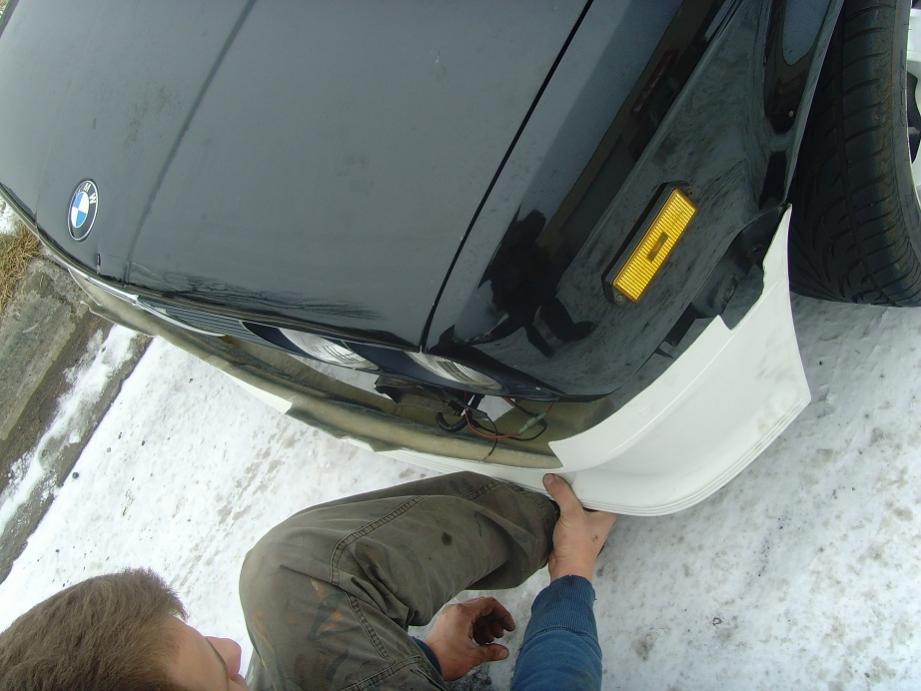

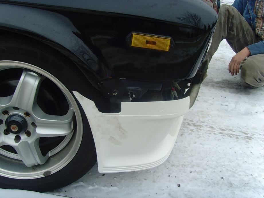

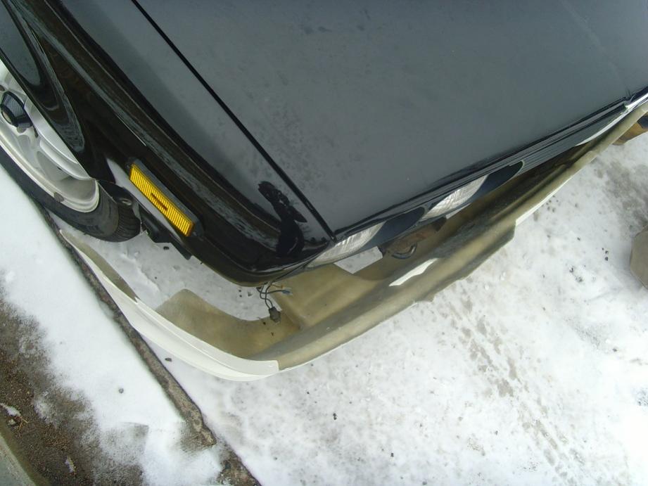

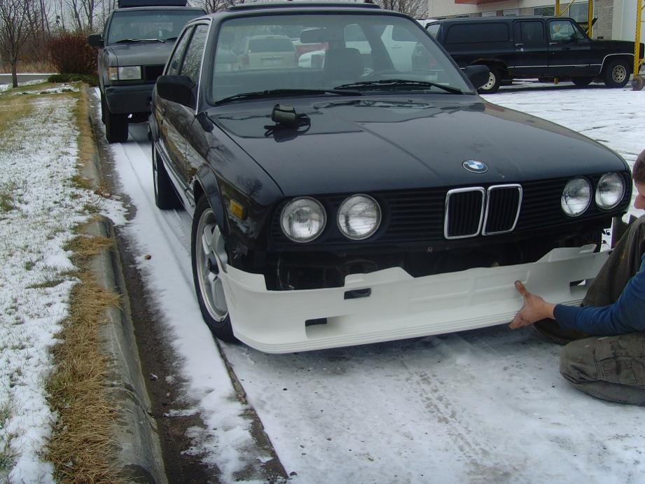

                              photos of the installation
                              Any inputs?
