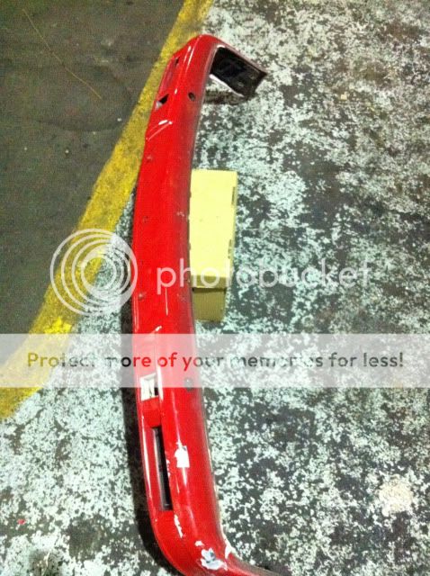

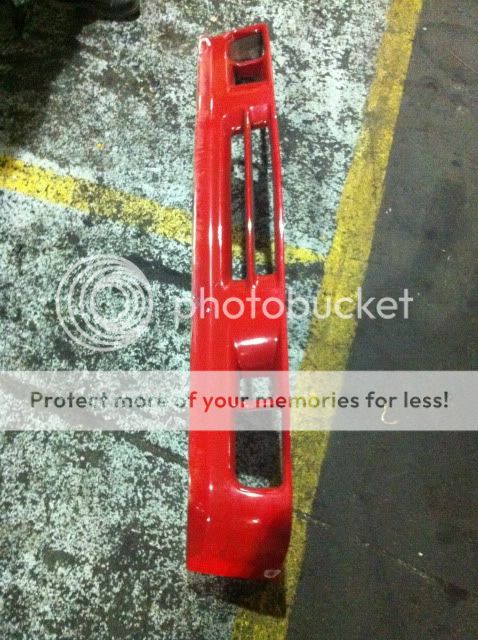

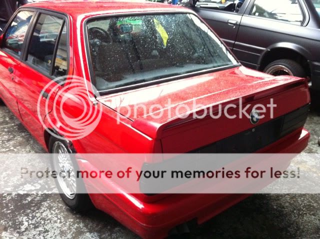

        Thanks guys appreciate it very much.
        Last question. I would assume that doing the swap to Mtech2 is the same process w/ late model plastic bumper swap writeup correct?
        This is what I'm getting.
        Mtech2 Front Bumper
        Mtech2 Front Valance
        Mtech2 Rear bumper w/ valance
        I know I need late model bumper shocks and late model turn signal connectors, misc clips. Anything else needed?

          Yeah the front bumper and rear use the same stuff. The only thing is the shocks are different sizes from the regular plastic bumpers. I am pretty sure this is for the rear only.

                      if im not mistaken the late model mt2 rear is different than early model.
                      when doing a plastic bumper swap on early models you have to shorten the bumper to fit correctly
                      and having the valance and bumper as one piece will make that much more difficult.
