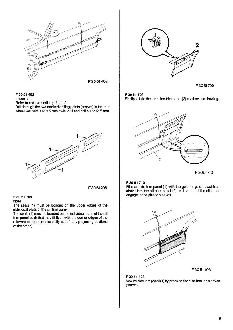

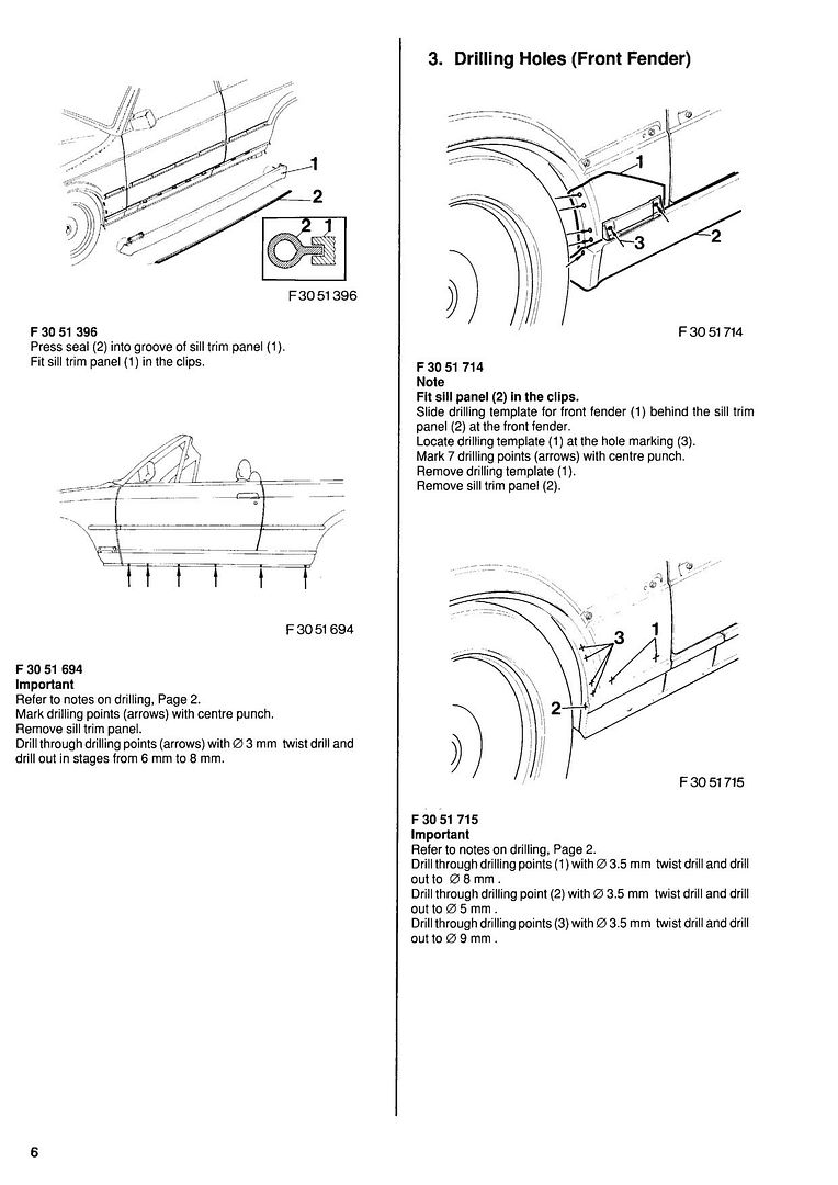

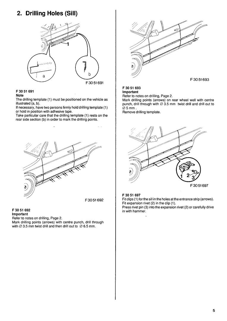

    basicly my issue is. i have a 4door facelift. and im converting it to full mtech 2. the hardest part ive run into is the sideskirts. the slap 'em on approach is easy. but i want it done right. with the right clips, the right fitment ect. i mean if someones gonna go through the effort to do something why not do it right? so that involves drilling the side sills to fit the clips for the skirts. so i need the drilling jigs.
    does anyone have these? or a digital copy of them i can use to make a template with?

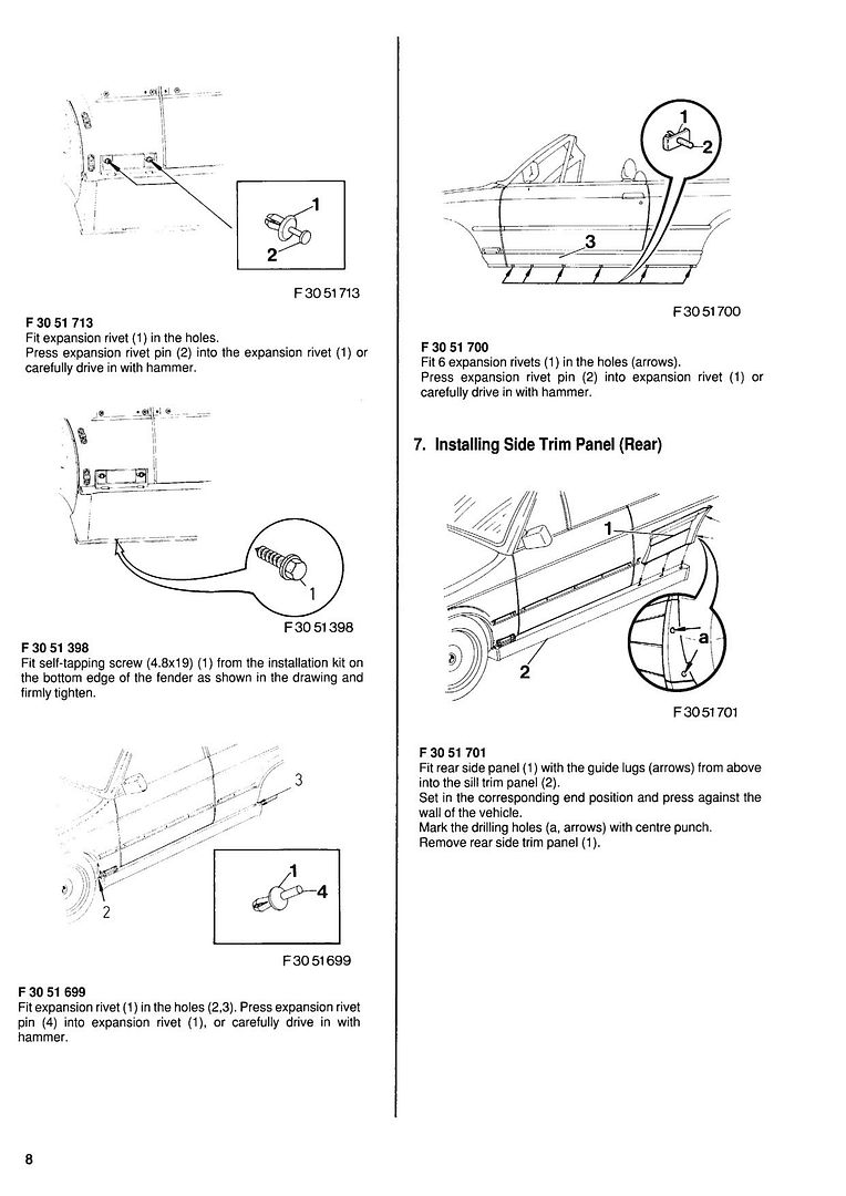

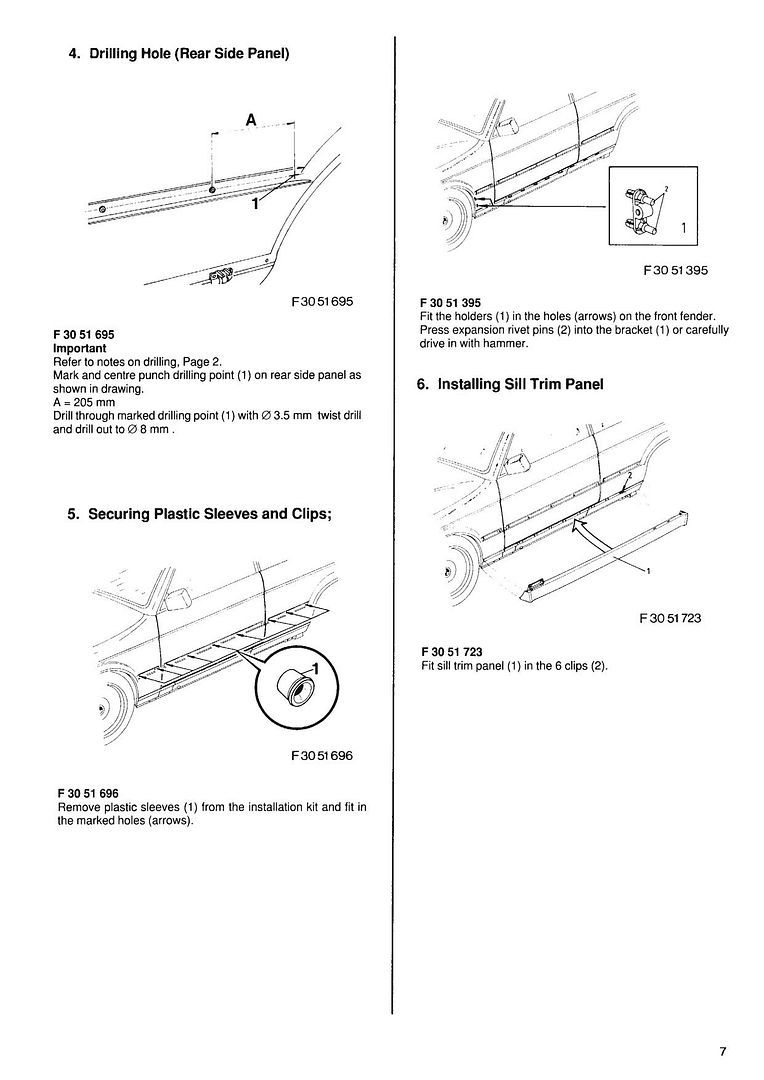

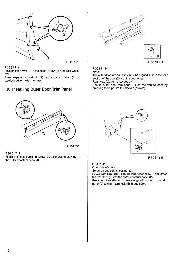

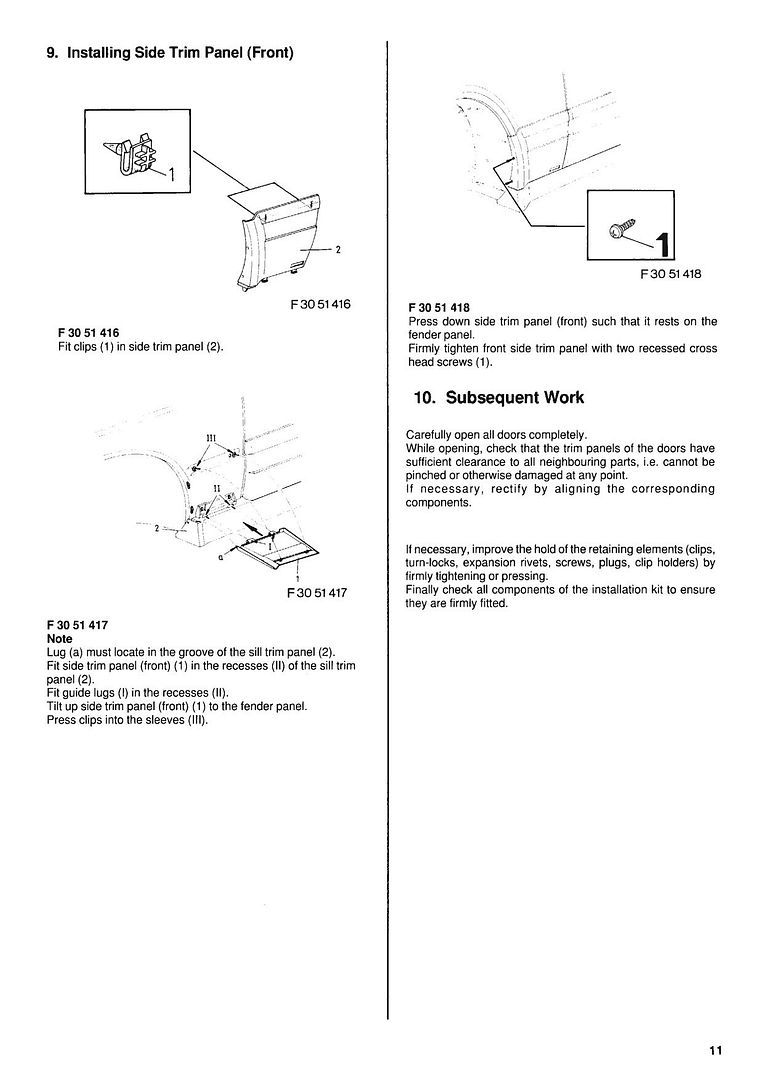

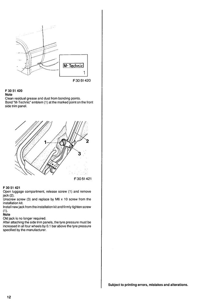

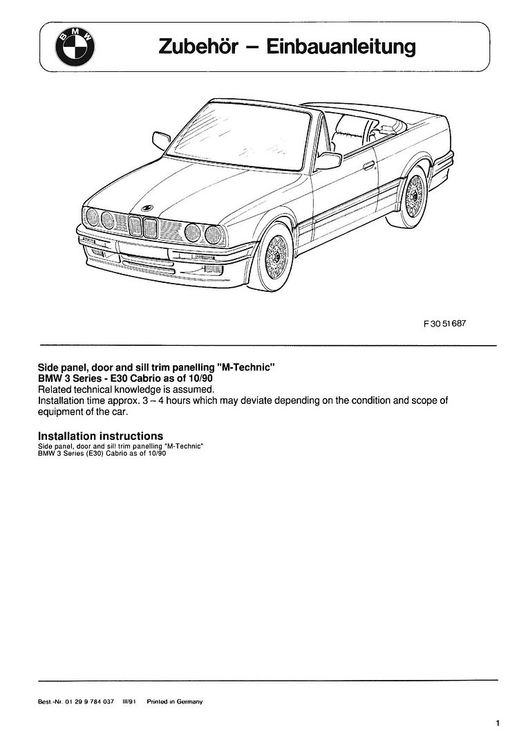

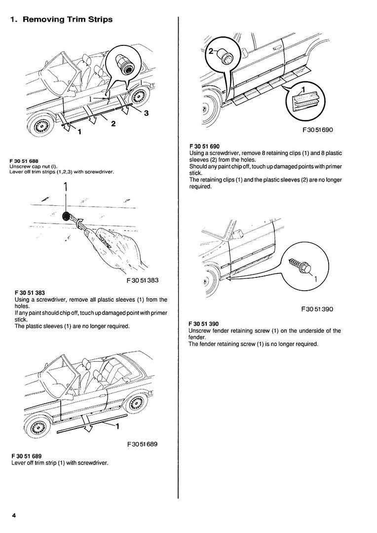

    These are instructions for a 2-door & convertible but they may be able to help you with your 4-door

      that is good info. from TIS bmw instruction program is it?
      but it still says to drill to the drilling jig. it still doesn't give any measurements as to where to drill which is a pain.
      thank you anyway
