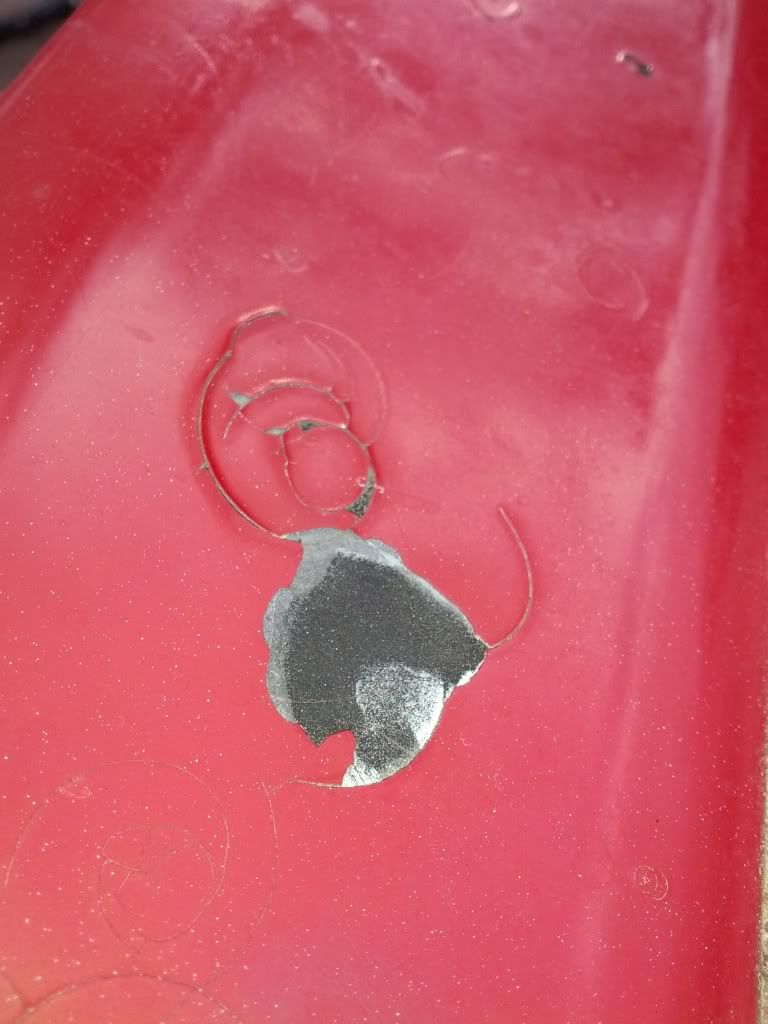

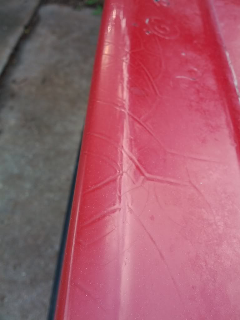

    Hey guys,
    I looked around in for an answer and couldn't find one, but is there a way to to fix the trunk lip spoiler? mine has little circles in the paint, and chips and just in kinda rough shape. Can I sand it down and stuff to fix it? or should I just buy another one? and is it possible to take it off and put it back on?

        Of course it is possible to take it off and put it back on...
        Now.. You have to be more specific.. By damaged do you mean the paint or the actual rubber itself..? If it's the rubber you pretty much screwed because it flexes in the heat so bondo/any other type of filler will separate from the rubber when it bends.
        If its just paint, sand, primer, paint indoors where the temperature won't fluctuate because changing in temp will cause the rubber to flex and create cracks. Once satisfied, allow 3-4 days to cure and harden before you mount it back on

            All the cracks and flakes, are like this one
            But I'm don't know what this is,
