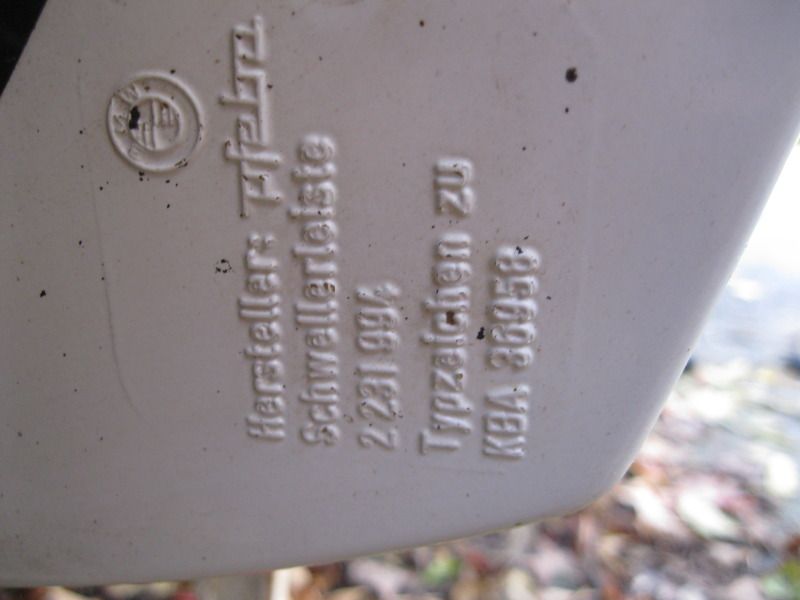

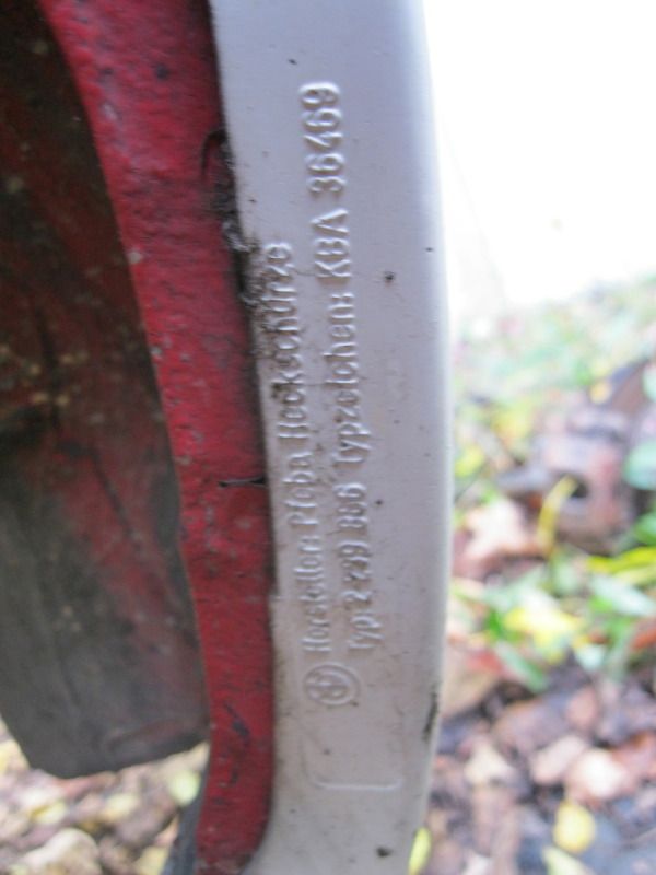

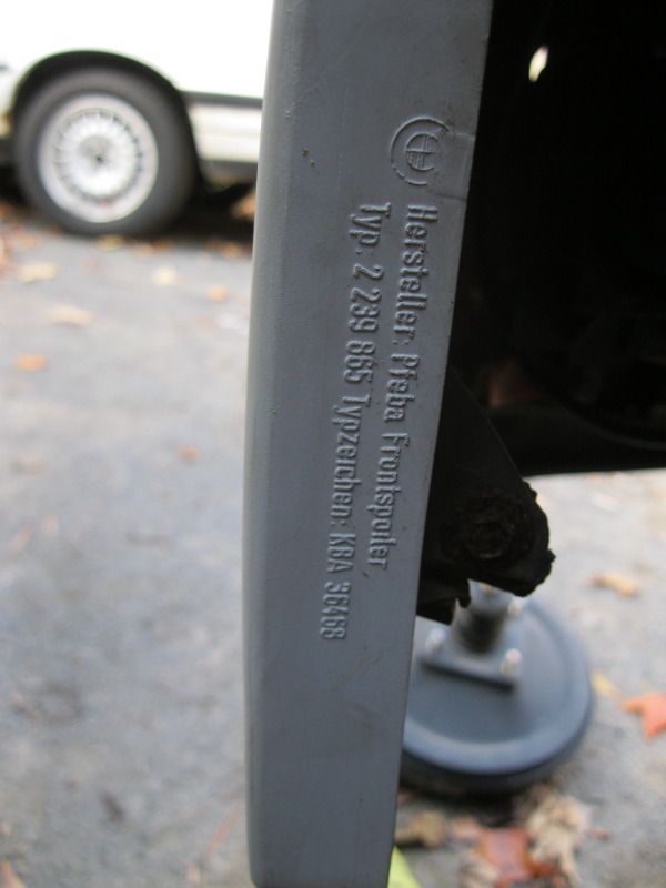

    So I'm in the process of selling my project vert, which I was told when I bought had an OEM Mtech II kit on it. Had one person say it wasn't so now I'm not sure. Has the BMW stamps w/part numbers for the Euro Vert kit. Here are a few of the pictures. Was hopping some other people could give me some insight. Thanks.

    Part numbers match origional mtec numbers.
    Check out the link below, No.2

      Based on the pics you have on the other thread I can say that your front bumper, rear bumper, door pods and side skirts are 100% genuine. The only questionable piece is the front spoiler since it looks to have been repainted, and the fitment looks slightly off on the sides.
      Easy way to check if it's genuine or not; if the backside of the bumper is yellow urethane then it's genuine. If the part is fiberglass then it's a replica.
      btw, your kit would be considered "US spec" since the bumpers have the side marker cutouts. Otherwise there's no difference between euro and US m-tech II.
