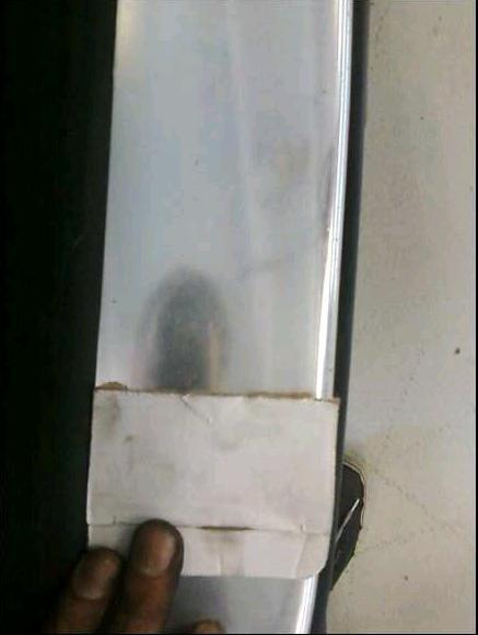

    i didnt have a tape measure so i just used this card.
Name:	DB card full.jpg

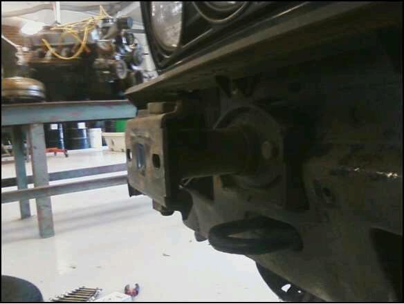

    after removing two bolts (13mm i think) on each shock i got this, next i just removed the two connecting into the body
Name:	Bumper shock.jpg

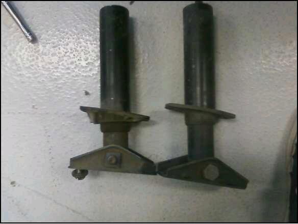

    these are the two shocks side by side
Name:	bumper shock compare.jpg

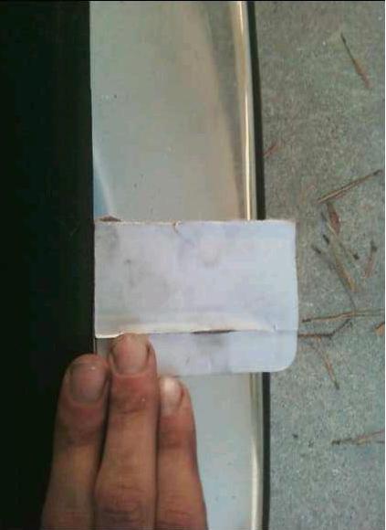

    same card measuring the bumper
Name:	shorter bumper1.jpg

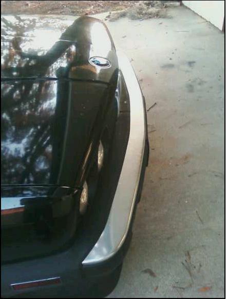

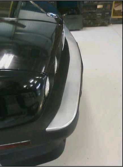

    last pictures
    and this is the final outcome of the bumper
Name:	shorter bumper full.jpg
    like i said, its not a huuuge difference but its a better alternative to tucking and it only cost 12 bucks.
    one final note, if you had drilled through your bumper to mount up your valance then you will have to redrill/mount as the holes you originally drilled will be pushed back farther.
