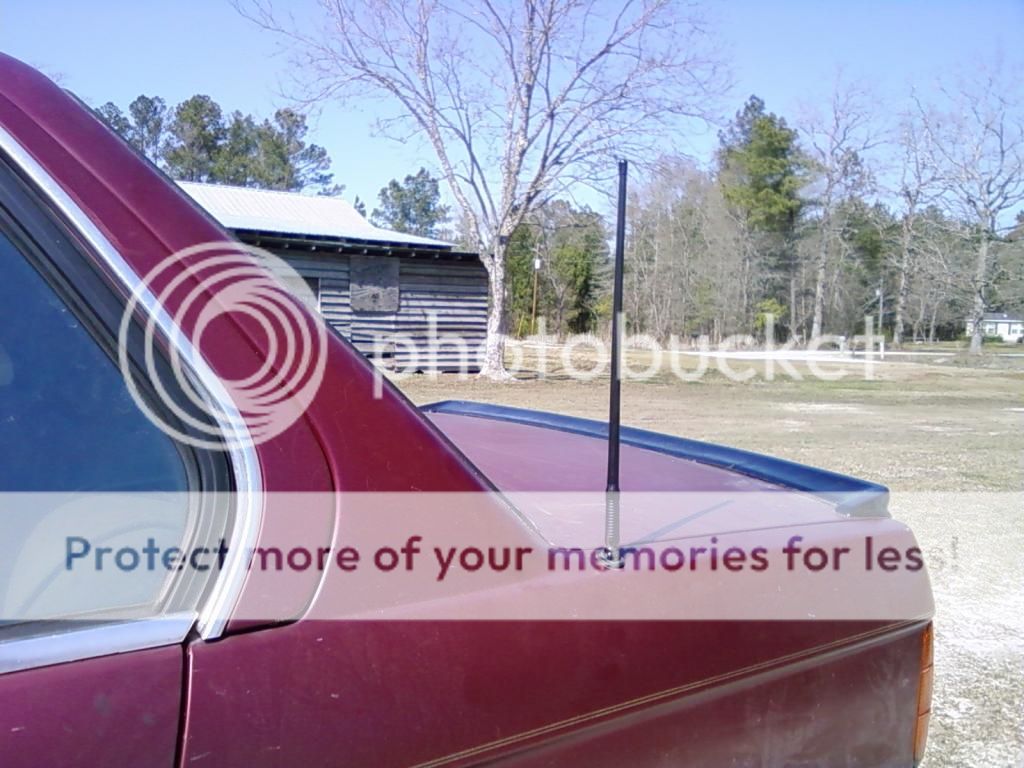

    I recently have gotten tired of the stock antenna especially because it never worked so i went to advance only to find out that nothing fits:-x Well i decided to make one fit, so i bought a universal fit short antenna. well i took off the threaded sleeve that holds in the stock one pulled out the antenna and cut the sleeve down to the threads. then i ran the adapter through the sleeve and fastened on the new antenna(the adapter had to ground down to a smaller diameter to fit) then i just threaded the sleeve back in place, looks purty gewd i'd sey

    Look alright, tell me about your radio reception? Remember to unscrew it when you go through an automatic car wash...

      reception is actually better than with the stock antenna, i now have stations i was never able to pick up at all before.
      and i do not plan to go through any auto car washes. i am a big believer in the good old fashioned hand wash.
