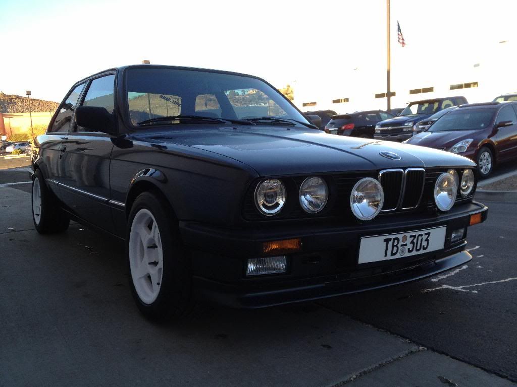

      heres this:
      that is my car litterly i just got it and I'm fixing it up. the front valance you see on it doesnt even fit and is just screwed into sheet metal behind it im going to take it off and and replace it.

          there is a lot of goodies on that car, steering wheel looks like the small mtech 1, and those wheels, if genuine worth serious coin. Parts on it worth more then the asking price , nice find.

            yeah are those 3 piece OZ twisties? nice wheels.

              Wheels are genuine I have records from when the po bought them, as far as the dog leg sadly no it doesn't it's left and up :(

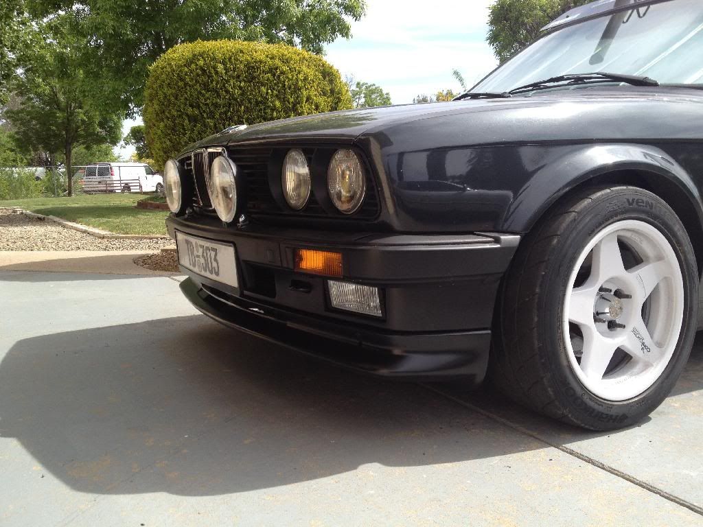

                      85 US valance. Note the corners are cut out, those are for the diving boards.
                      86/87 euro valance, note the foglamps and lack of cutouts. This valance also stays straight instead of tapers and the lip gives the car a chin.

                          Damn, Holland, that's a good-looking car. That bumper - valance combo is sharp.
