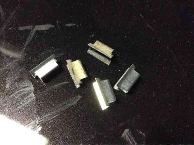

                          You need the clips....... Fml
                            Ive parted 3 e30s and not one of them had a clip. There is only a small square piece that seals the gap between the long trim piece over the windows/door, and the C pillar trim. The long piece over the top of the doors pinches onto the gutter.
                              There are clips. 3 per side if I remember correctly. This is what they look like. Click image for larger version
                              Part 51131863499
