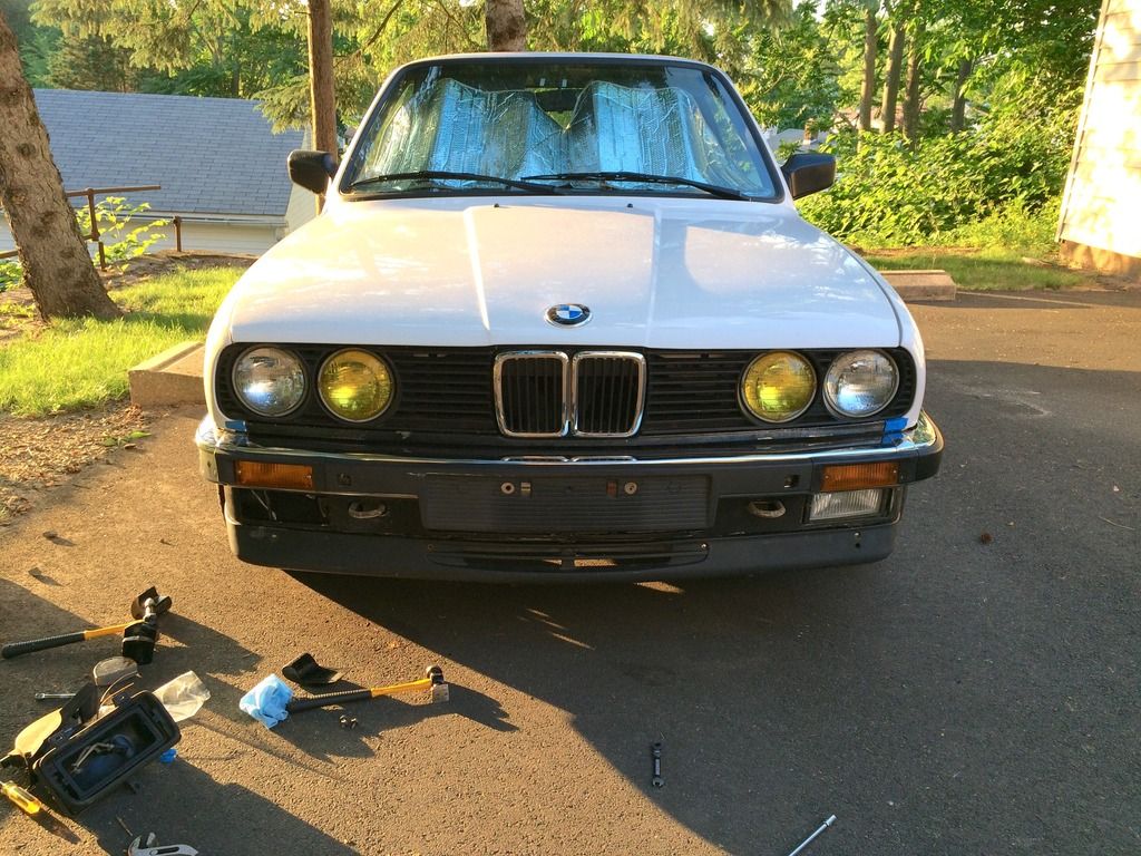

    I'm in the process of fitting Euro bumpers. I have the euro valance, which i'm going to paint. But i'm missing a fog light lens and surround (I have the bucket and wiring). I read older posts that said the E28 535is fogs are the same. But those are NLA now. I can't find any.
    Do I have any other options outside of buying the expensive Euro fogs? I really just need one lens and bracket (or a matching set of an alternative)
    Here's the valance

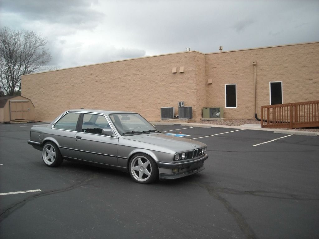

    Also, the lip I have is decent. But what other lips bolts up to this valance? I'm curious about this lip, what is it?

    The lip I believe is the same as what is used on the US cars here too. The one in the pics is like mine - has the cut out for the oil cooler. I think they make them without the cutout too. There may be some aftermarket stuff out there but it would likely be harder to find.

        Thanks. I haven't seen that lip on any US cars. The car pictured is a Euro car. Do you know what it would've come on? I like how it's a bit more aggressive than mine.

          That lip on the silver Euro car is referred to as the Jimmy Hill lip.
