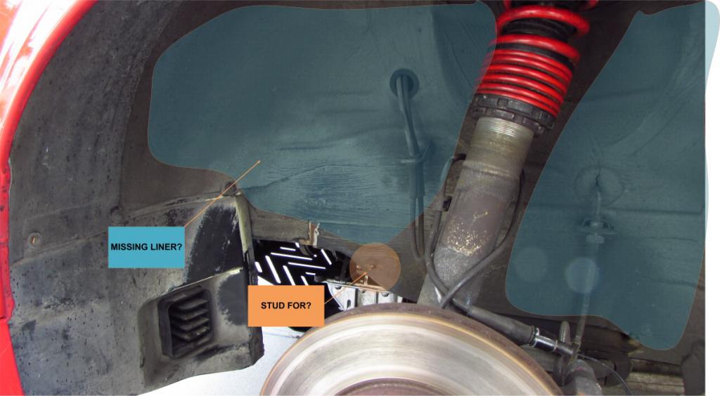

    Hello,
    Does anyone know if there is suppose to be a fender liner around the shock/spring area? I see a stud for a bolt.. I am unsure if I am missing a inboard fender liner..
    If yes, what is the part number (LH and RH)?

    There is no missing liner. That's what it's supposed to look like.
    However, you are missing part number 51711965899 Engine compartment screening. It mounts to the stud pictured, as well as the corresponding stud on the other side, and two studs that are hidden from view on the underside of each of the frame rails.
    It's pictured here: http://www.r3vlimited.com/board/showthread.php?t=202002

      Cool Thanks!..
      I could see some use for that part.. (Engine gets less dirty)
