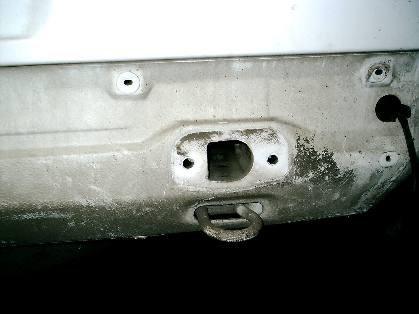

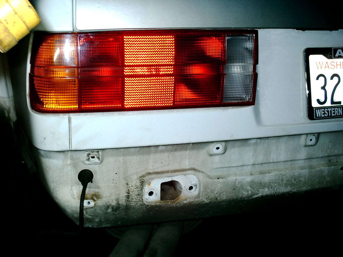

    1) Does anyone know the correct process to mount the rear euro bumper on an US-made early E30...here are some links to some pics of the mounting holes and the mounting brackets...
    Where do we drill the holes? Do we need to weld a plate first? if so, where?

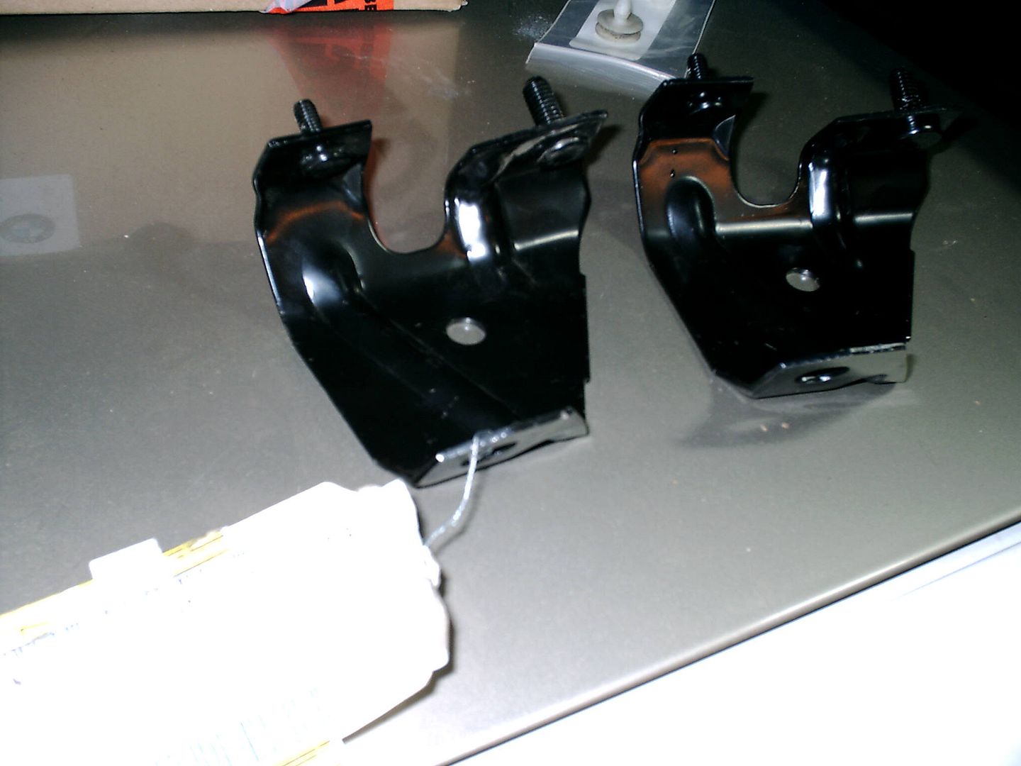

    Brackets (are they the correct ones?):

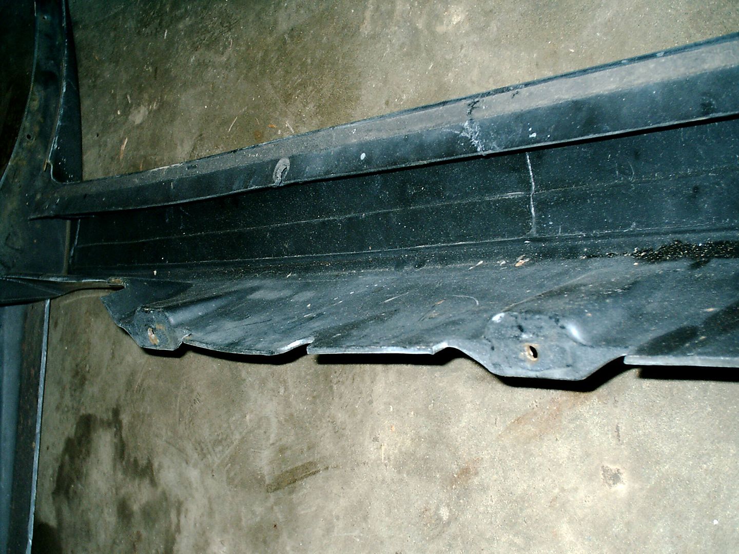

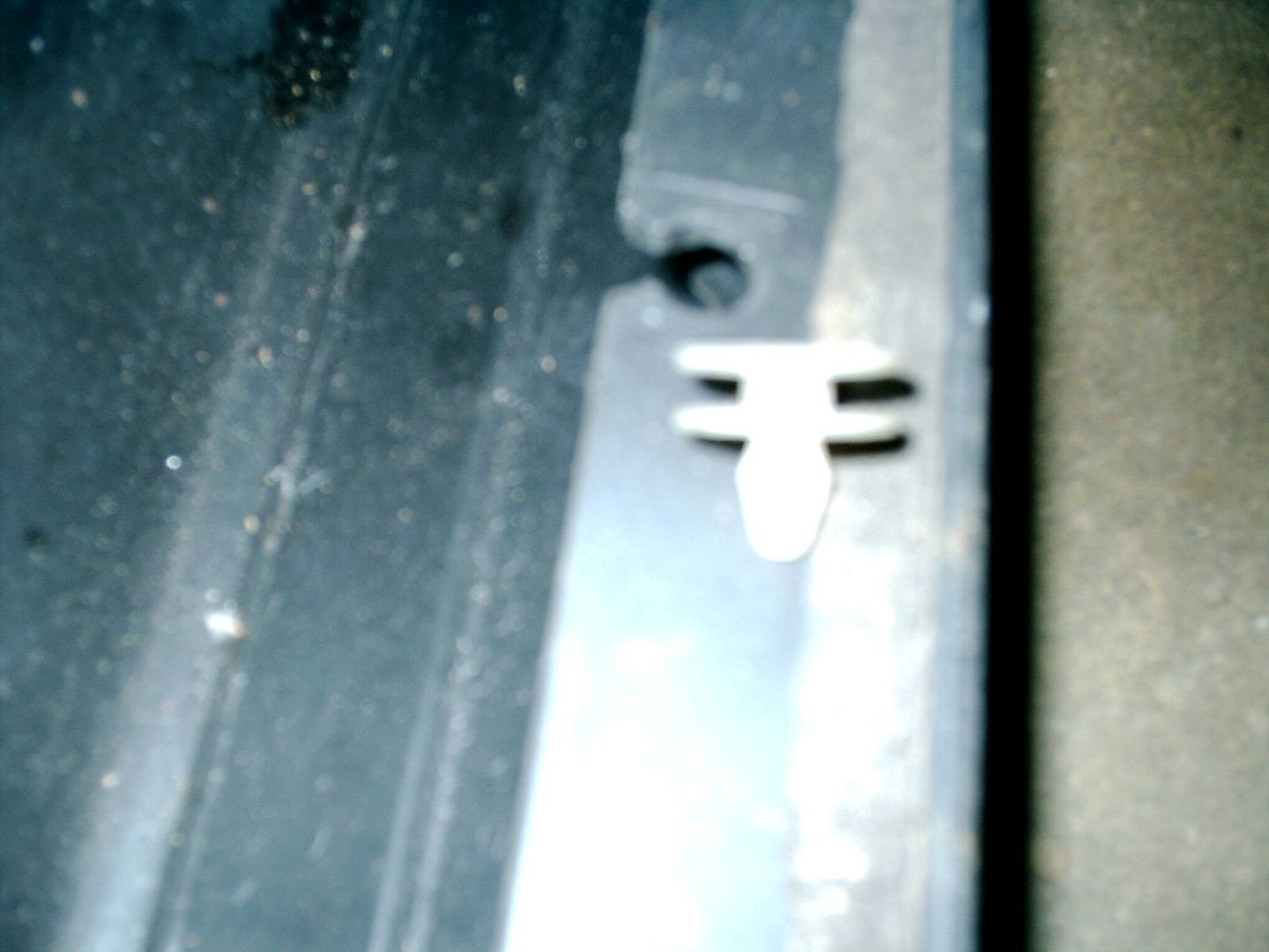

    2) We don't seem to have the correct mounting hardware for the sideskirts...
    What is this clip, how many do we need and where can we find them (i.e., anyone know a part number?)
    What else would we need to install the sides?

    ---Do we need to weld a plate first?
    No
    You will need to drill 1 new hole per side.
    Mount the bumper mounts to the bumper, and "trial" fit the bumper... lining up the sides. You'll then be able to see where to drill the one extra hole.
    ---Brackets (are they the correct ones?):
    Yes
    ---What is this clip, how many do we need and where can we find them (i.e., anyone know a part number?)
    You drill into the rocker panel at spaced intervals and then insert plastic inserts. Those clips snap into the inserts. Look across the top of the sideskirt, and you'll be able to count how many locations.
    ---What else would we need to install the sides?
    M3 style lower sideskirt clips. One for each "hole" in the bottom of the sideskirt. Basically a little clamp that has a phillips screw through it to hold it to the rocker panel.
