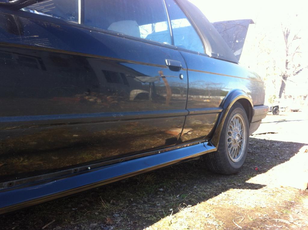

                  Here are some early mock pics. In black primer only. No trim yet, but the fit isn't bad. The rockers are only slightly visible from about 25', But I'm 5'7" so I have a lower perspective...
                  The skirt has custom made aluminum brackets drilled and JB welded to the back of the skirt then screwed to the rocker under where the trim goes. So if it sucks for whatever reason, I can just put it back to stock with no visible holes. They'll be there, but under the oem trim. On the fenders, I'll screw them up and into the fender on the inside lip, also not visible in the event of removal.
                  To sum up: All pieces will have screws into metal. The flares will have 3m mega super permanent double-sided sticky tape + screws, and the skirts will only have screws.

                    looks pretty cool

                      one more teaser...

                          I hope no one ever actually went through with this because that looks horrible.

                              Yet again, reviving. Does anyone have any FINISHED pictures they'd like to share?
                                The last pic is as FINISHED as it got. You should just do it if you want to see what it looks like FINISHED. I ended up removing it because I didn't like it enough to do the other side of the car.
