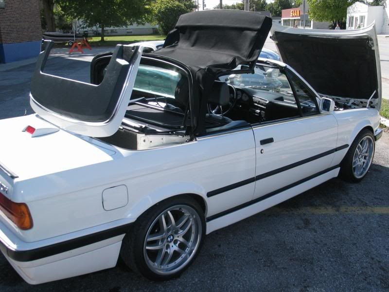

                  • talltorontoguy
                    • Apr 2006
                    • 267
                    I followed the writeup for mine two years ago. Worked flawlessly. Couldn't find any closeups but trust me, you cannot notice it.

                    • TexasTerp
                      • Jan 2009
                      • 3541
                      Yeah I'll definitely pm that guy on the other thread.
                      talltorontoguy - that looks like a great job! Two years? well that sounds like a good confirmation this will last to me!
