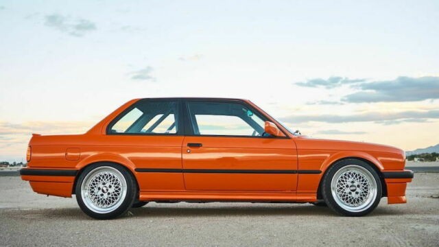

    Hello I see that BMW still make these and I want OEM fitment can’t make out for sure which style side skirts these are? Could anyone let me know if they know which style they are?

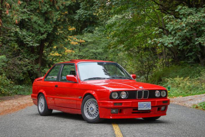

    The "sport" skirts from ECS, also commonly called "iS" sideskirts, are the style as pictured on the car in the side profile pic with the BBSs. The other car in the 3/4 view has a full Mtech II kit on it which features side cladding in addition to sideskirts which are totally different from the "sport" skirts. The "sport" sideskirts will work on any e30 except for cabrios. The Mtech II kit only fits on '88+ face-lifted cars.

      That’s what I kind of was thinking! Thank you! Bummer. Was hoping they were the mtech style
