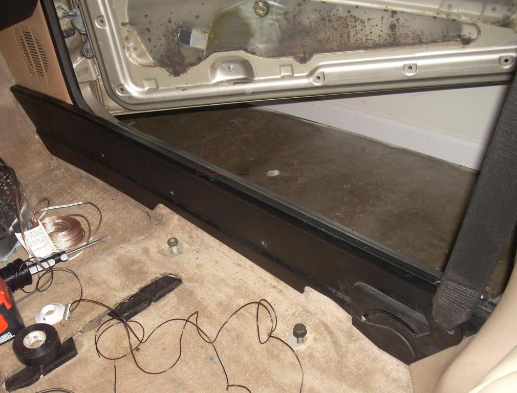

    I can not get the interior trim along the door sills to come up. I have taken out all the plastic rivets and can get it to move but do not see what I am missing. Anyone have some quick advice on how to get them out? Bentley does not even address verts for this task.

    Pic of what trim you are speaking about?

        passenger side
        The arrow points to what I trim piece I am talking about. I removed the 4 rivets but am lost as where to go from here.

          I think there is another rivet underneath the seatbelt cover thingy. Then it should just wiggle up and out.

            The cover for the seat-belt connection will pry straight off. One fastener is under the cover. Remove it and trim will slide straight up.
              Agree - that is what I recall too.

                Thanks for the help, I figured it was something like that but the last thing I wanted to do was play with the seatbelt cover thing. With my luck I would crack that thing in half!
