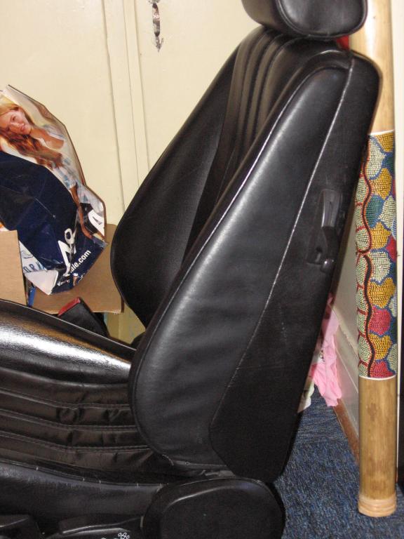

    well, i finally found a set of seats that are worth some time, but Ive never really worked with leather before. So i want to know the best way to restore these. Is a good conditioner all i need to get the lines to go away?

        yeah, i got some dye to play with today, it helps a lot for now... one day ill take it in and get that bolster spot repaired.
        SEM GM black was what i used, seems like a perfect match, i didnt completely dye the seats... only the spots that needed it. And there are no color changes!
        I also grabbed some mothers conditioner, so after the recommended 24 hours after dying ill hit them with conditioner.

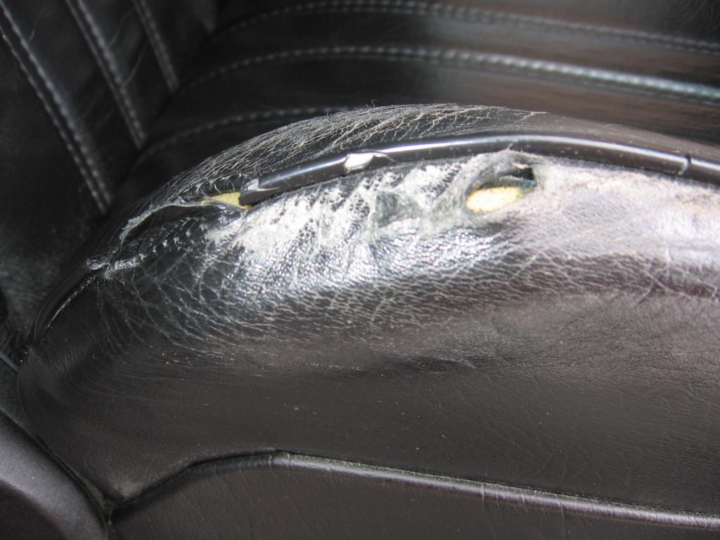

              The grey showing up on the seats is NOT repairable. Once the suede beneath the black or any color leather shows up, it's done with. You'll need to replace the piece of leather. I had the same problem with my IS and just removed a piece of leather from a recently redone seat. Since my seats were pretty mint it didn't need dying. Before and after shot of the replaced bolster.

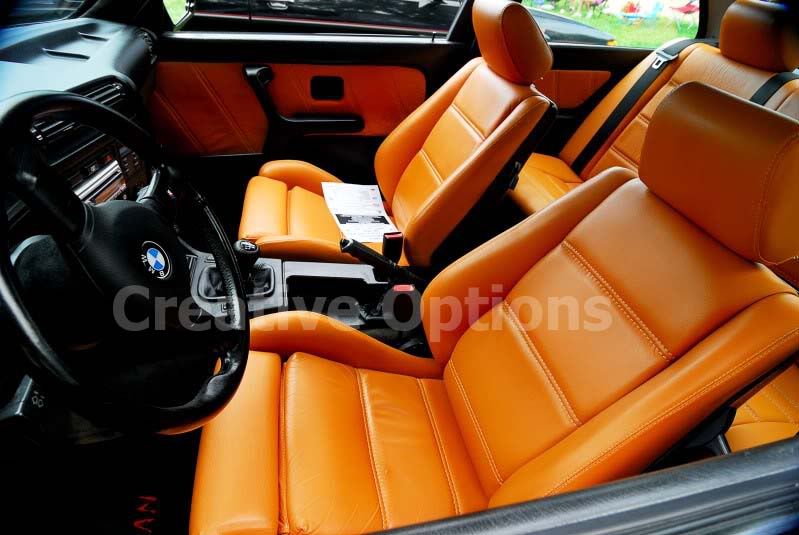

                To properly redo look into Leatherique products.
                Or have Creative Options cut you up some new skins.
                  I went a step further for the same money; got genuine Italian leather from the manufacturer hand picked and had it brought to upholstery shop. Did it in two tone for me. Creative stuff is awesome, I have seen the quality from their pics, But I don't know where they get the leather from. Since my friend has contact in LA he flew down to get some work done and got my order in to his buddy. Just finished the head rest and replaced a few bolsters. Now gonna get started on the seat and back cushions. I used porche leather color code to do mine.

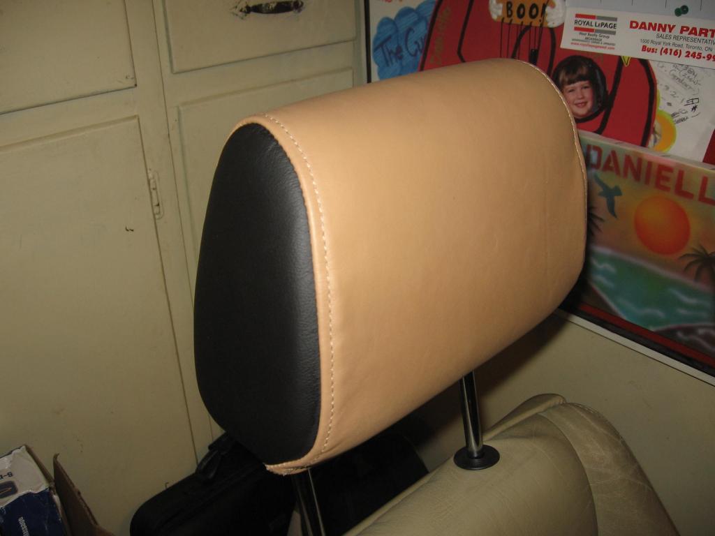

                  • Tricked 323i
                    • 617
                    Good looking headrest. I have leather suppliers in Cali, NC, Germany, UK and Italy.
                    OP if you need dyes let me know, I have kits as low as $55 shipped and it does really well.
                              Kevin
                              Black German Napa
                              might take you up on some dye in the spring! in the sunlight, the difference in shades is noticable to me.... which wont do :p
