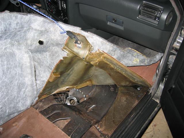

    • glucklich21
      • 1912
      Hope you don't find something like I did...
      • Stanley Rockefeller
        • 445
        how did that happen???
        • glucklich21
          • 1912
          The stud on the other end of this stud rusted at some point and spread to the sheet metal over a period of years. It even rusted through the heat shield...
          All fixed and god help this car if any water even dares go through these seams.
          • browntown
            • Jun 2004
            • 3524
            I did that and found a surprise,
            Here's a pic of the rust ground off and prepped for welding
            • browntown
              • Jun 2004
              • 3524
              I think gluck and I had the exact same failure point. The stud holds aluminum foil heat shield under the car. It rusted up into the floor pan on mine too.
