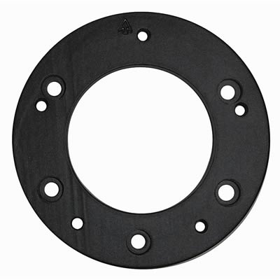

    I picked up a gt grant steering wheel from a Porsche 944 at a local yard for 10 bucks. I can't seem to find a grant adapter for the e30. I've seen the momo one is popular, but will the grant wheel fit on it?

    i don't see why not, the bolt pattern seems the same to me.

      Momo = 6 bolts.
      Grant = 5.
      You need to find a grant adapter, or I suppose you could buy a momo and redrill it.

        i couldn't find a grant e30 adapter, anyone know where to find one?

          one 5 bolt Grant to 6 bolt MOMO and you are in business!!
          Free Shipping - Grant Steering Wheel Adapters with qualifying orders of $109. Shop Steering Wheel Installation Kits at Summit Racing.
          or if you dont have a MOMO adapter, here is the Grant one for you
          bit pricey though

            i still need the hub with splines to adapt the wheel, so i guess the grant it is... thanks man.
