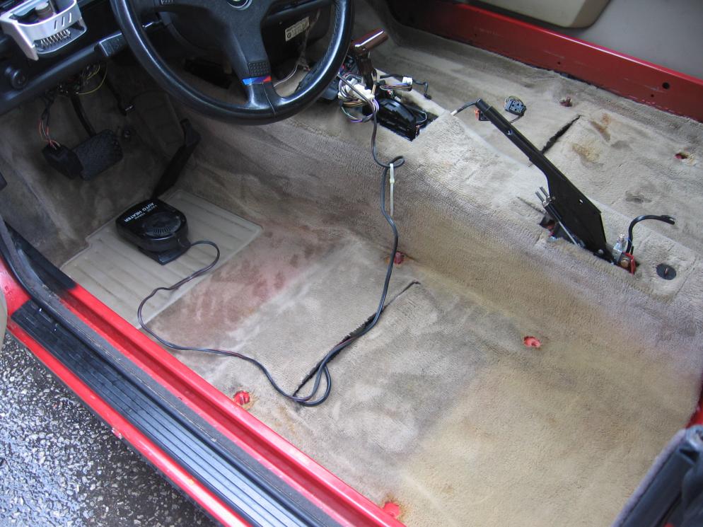

    ok, so I got duplicolor at what we call "Canadian Tire" store. I bought the Desert tan color; I decided I didn't want to go black and since it is pearl beige I am hoping it could it hide the discoloration by blending.
    Does this paint wear off after some use? I'm just experimenting, as I do have a replacement anthracite carpet.
    I know the carpet gets stiff after a few coats and it was recommended to use a carpet brush to brush it out to soften before the next coat. I then vacuumed it and applied the next one.
    Any advice would be greatly appreciate from someone who's done this application.
    thank you.
    Sounds like you got the right pointers down. Do it!

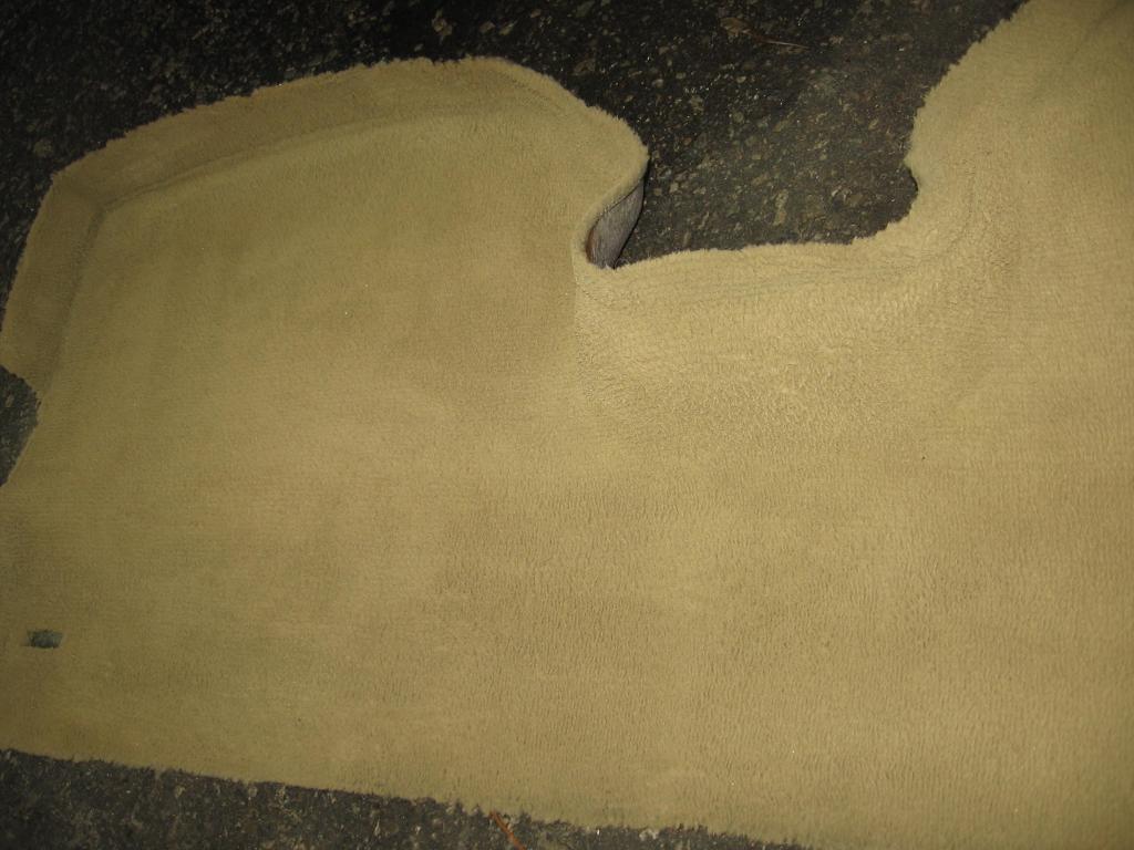

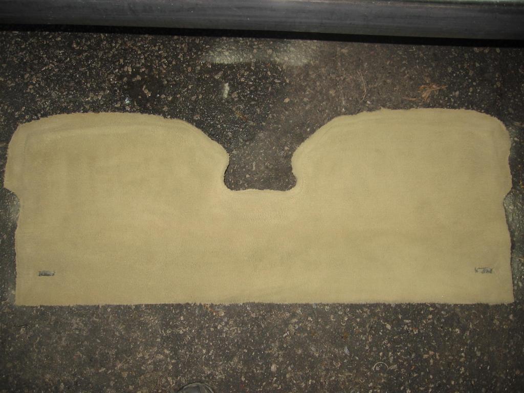

      Well, it looks like it's coming along...But I wonder when you brush the carpet will it pull the paint from the fabric? This was my concern; if this happens, then I'm basically wasting paint..lol.

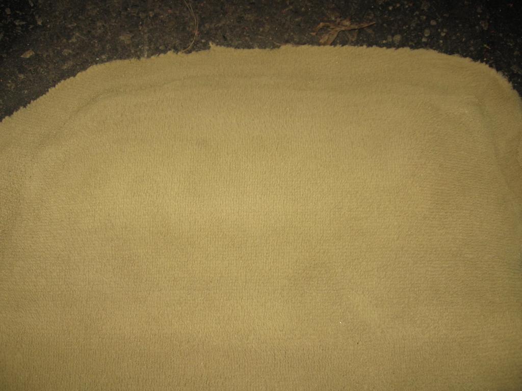

      Update: so far I am satisfied with the results considering this portion was heavily soiled along where the carpet meets the floor line and the drive shaft tunnel.
      I think I have 5 coats.

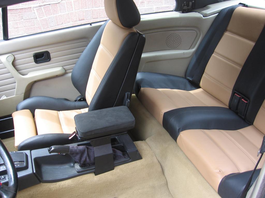

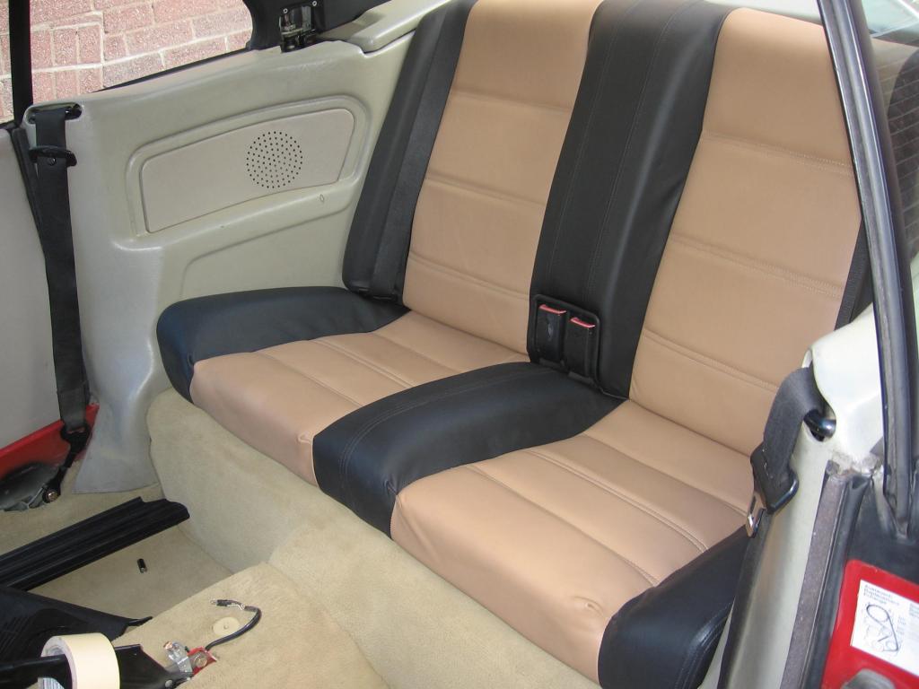

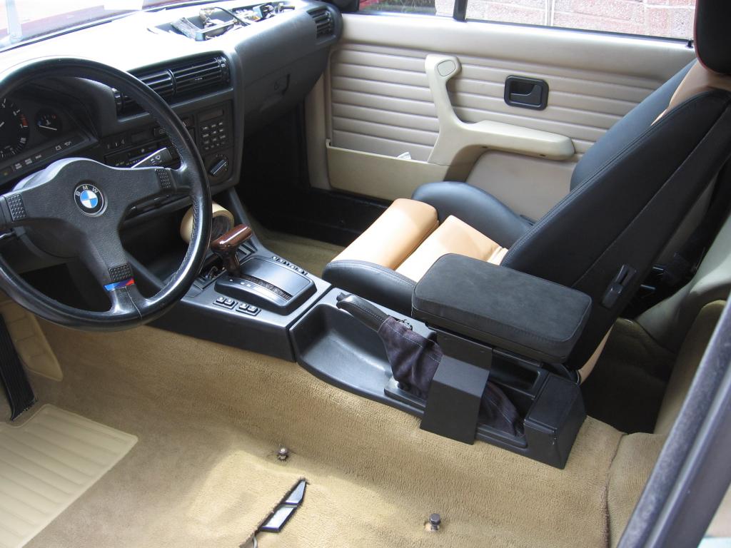

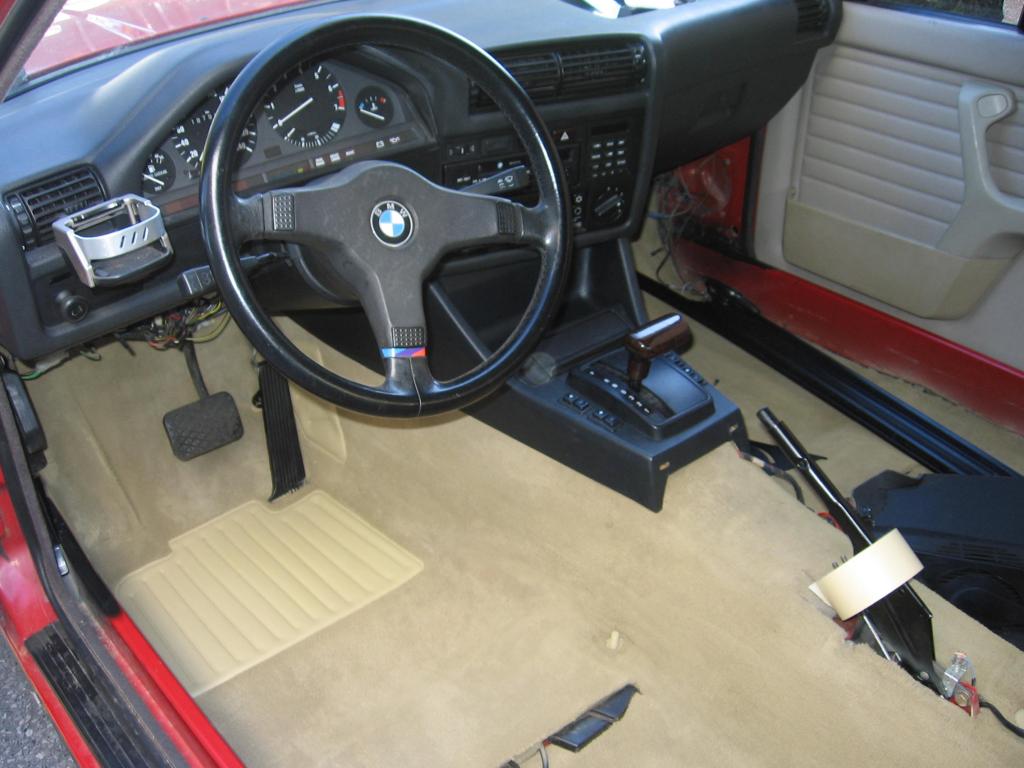

                  Well, I finished the job; with the exception of a few rough spots needing to be brushed out. I am rather impressed with the quality of the product and how it turned out. here is a before and after shot. This was a heavily soiled carpet with rust stains, dirt and pink dye.

                        Yeah, I was totally thrown off; I had trim shops tell it would come out so so and not so soft. Honestly, it isn't quite as soft as original, but we are talking paint here. lol. I tried the wet brush method but it didn't seem to work for me using duplicolor spray baum. So I just went back to the paint/dry/brush sequence. after 7 cans and some elbow grease I am satisfied with the results. now I just have to source either a really nice matching set of door cards from a later model vert or get a set of black and dye the handles the same as the seats. or the other way around. undecided yet. I think tan cards with black pockets and handles would look smart.

                          I think you can if you go with a liquid application; I couldn't get the spray method to work brushing wet. It makes perfect sense since the paint can get deeper into the fiber. but for what it is, and the coverage I got, it's not all the way through but I think it will last a good long while before anything shows up. I think painting/dying when you have close colors makes it easier. Going from pearl beige to desert sand is easier then going from beige to black. Although darker I would think you'd see shading until you touched it up.
