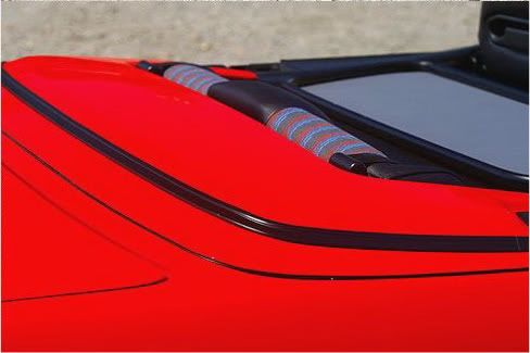

    It is a really easy swap. I have done it a couple of times. Or another option is to just pull the vinyl off of the lid you want to keep. The lids are finished in body color under the vinyl and once you clean the glue off it looks killer!

      ^^ cleaning the glue off is the way to go.. I helped a buddy do this and it makes the car look awesome.

                Ok, I think you are trying to swap the vinyl right? If so the vinyl is held on by several rivets, two phillipshead screws on each side, and glue. Once you get those off you can take off the chrome trim and pull up on the vinyl to release it. the rivets are the most annoying part of the removal. they look like these things . Anyways.. once the vinyl is off there will be a layer of glue on the cover... if you clean that off you will see body colored paint. I think thats what they are referring to above... but if you want to swap them, installation is the opposite of removal.

                    So for sure, there is paint under the vinyl on the lid?
