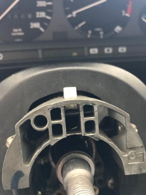

                        Hi. Just wanted to revive this thread bec I'm encountering an issue with the locking pin. I have managed to take out the steering wheel, but I must have moved it to lock when I pulled it out, so now I can't get the wheel in.
                        Any tips on how to go about this w/o having to drill / destroy anything? Can't put the keys on position 2 anymore even when i tried put the wheel in and steer it to unlock.
                        Would appreciate some help. Thanks.

                          Found out that locking pin was leaning towards the back and just had to flick it back to center so key could turn to position 2. Good thing I didn't use too much force to break it.
