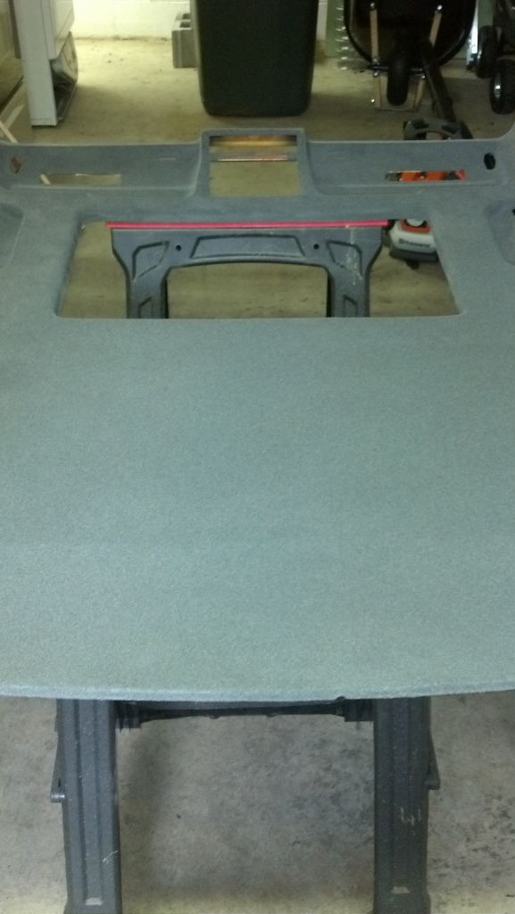

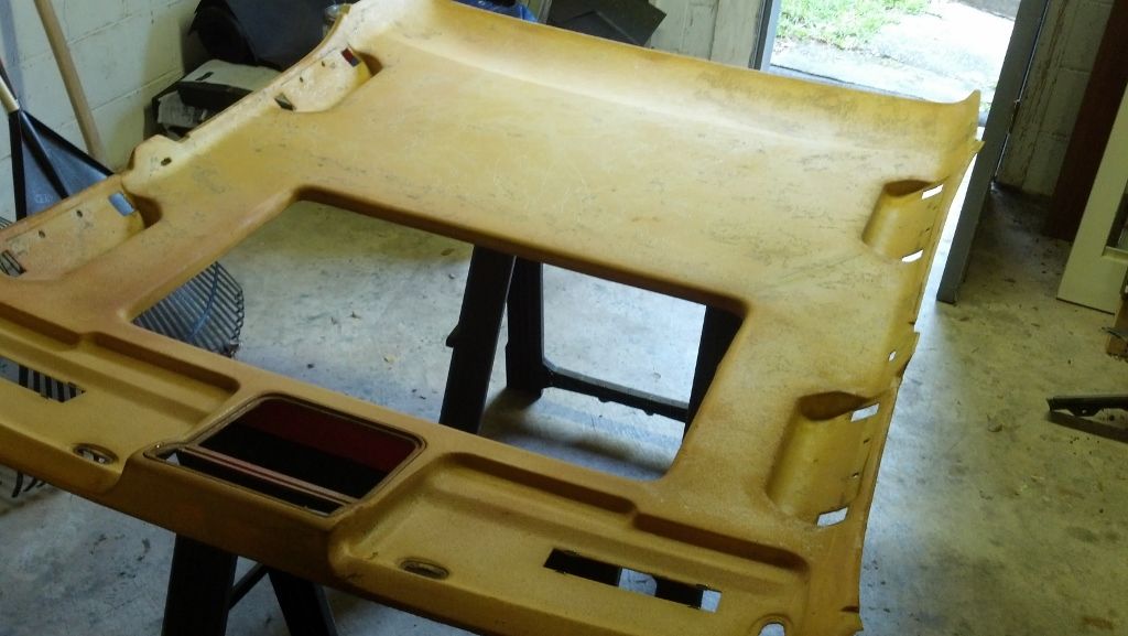

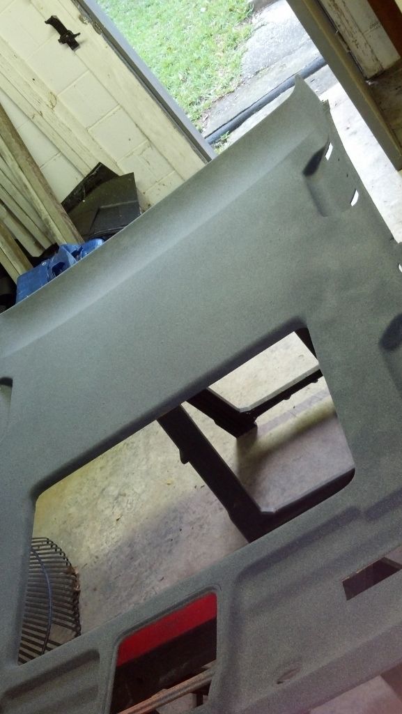

                          Just finished

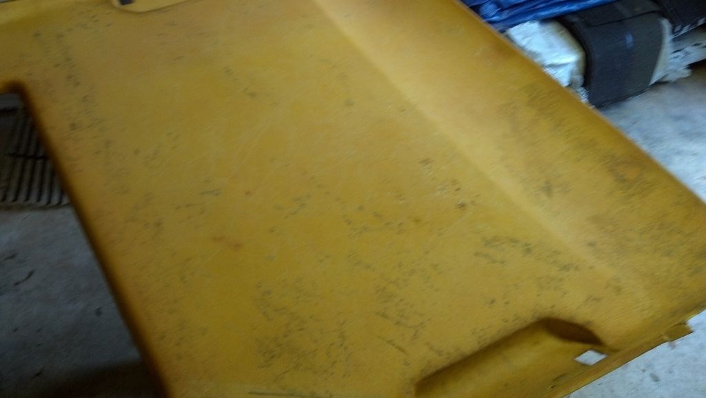

                          Before:
                          Yours probably won't have that marbling effect. That' from the trim adhesive after a failed cloth recover:

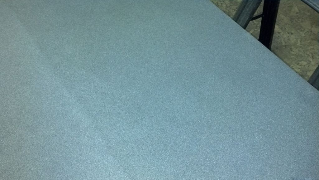

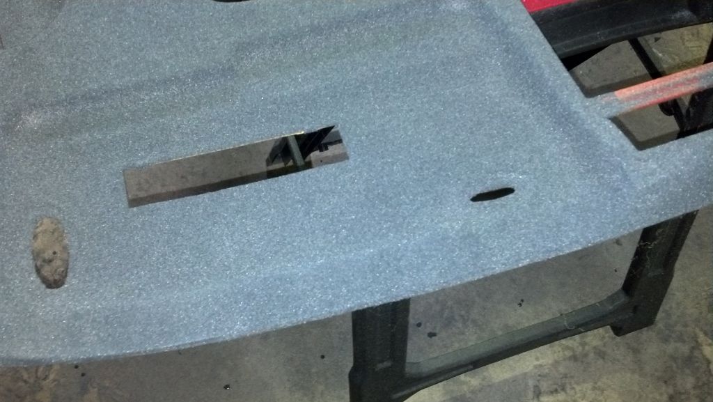

                          After:
                          Now I wait.
                          A couple of suggestions. Buy the big can of adhesive for an E34 headliner. It was enough (I hope) but just barely. I'm glad I bought the extra 3oz back of flock, I had to use a little. If you can spray on the adhesive, do it. It will go a lot quicker. The spray air can for spraying on the flock might not be a bad idea either but the twist tube works fine.
