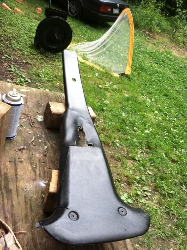

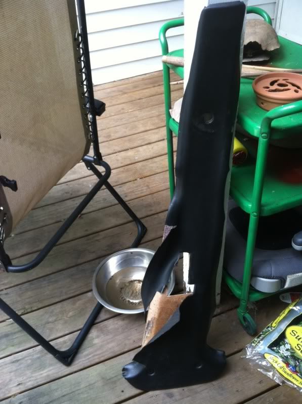

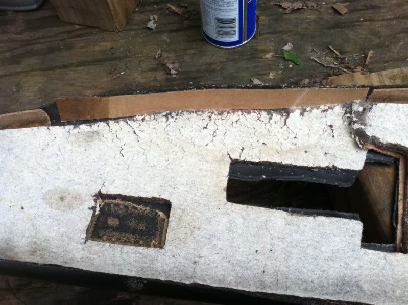

              I learned some things this past weekend.
              1) don't buy general adhesive spray even if that is all they have at the nearest store. it generally doesn't work for this application.
              2) if the panel is already broken, kind of sort of making the vinyl adhere a little better doesn't fix the problem.
              BEFORE REMOVAL
              BEFORE ATTEMPTING TO RE-ADHERE
              AFTER RE-ADHERING, FEELING PRETTY GOOD ABOUT IT DESPITE THE RIP IN THE SIDE, DESPITE THE MISSING PANEL PIECE.
              OH BUT WAIT, THAT MISSING PANEL PIECE IS IMPORTANT, WITHOUT IT THERE IS NO FRAME FOR THE VINYL. MAYBE THIS CARDBOARD STRIP WILL WORK? UH. NO DICE. A FABRICATOR I AM NOT.
              Bottom line, I need to buy a replacement.
              Later I can add a pic of what it looks like back in the car. not much better but at least it is not flapping in the wind so much.
