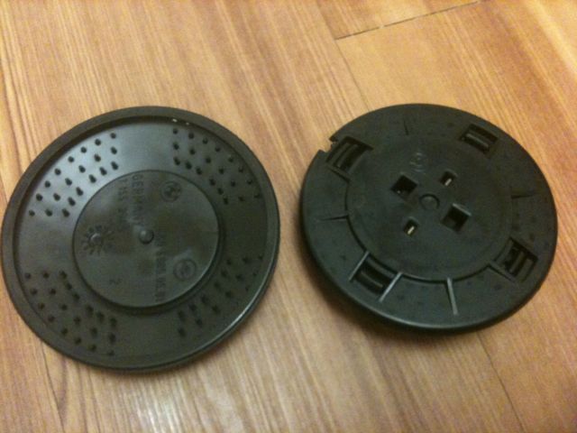

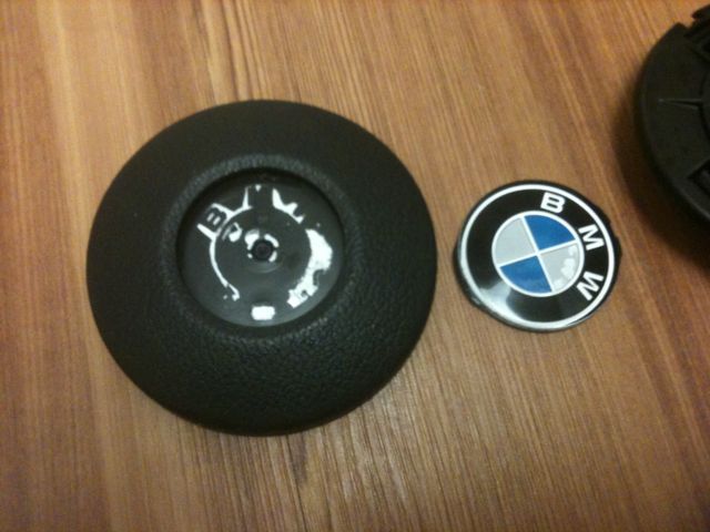

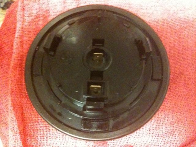

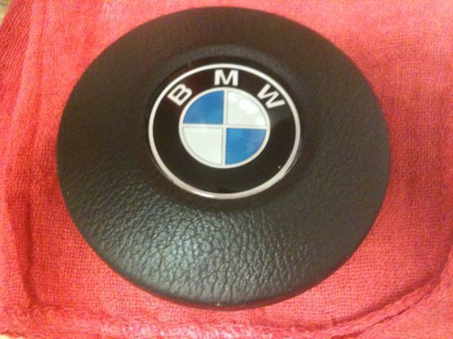

    Aha! The vinyl cover just peels off the button and then the emblem pops out easily. There's even an arrow behind the emblem to help get it exactly aligned.
