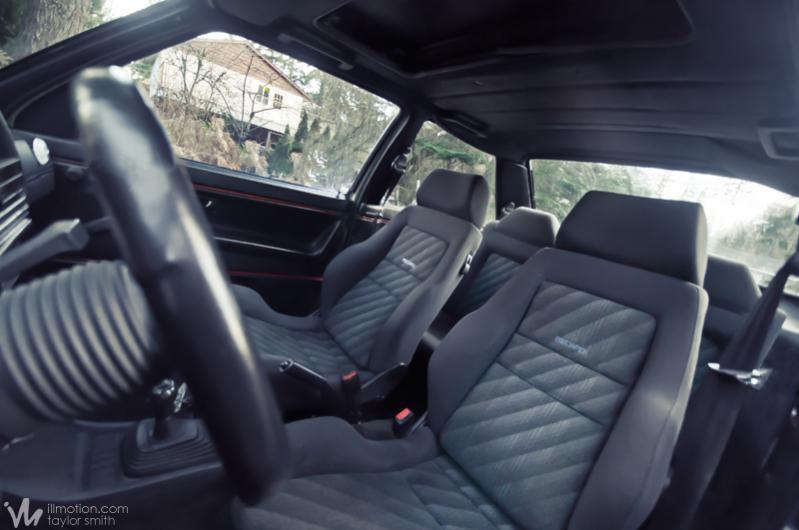

      I have canadian corrado recaro's in my car (I believe they are different from the us spec) and they are great. The came with power backs and power bases, but still have the standard 6-bolt pattern. They are a little bit wider than e30 sport seats, and I find them a lot more comfortable and more supportive in the twisties.

        frankie, got any pics?

          Originally posted by browntown
          Thanks guys,
          cynical, good to hear a direct comparison.
          They are these seats
Name:	corrado recaro.jpg
          I can snap some pics of them in my car tomorrow.
