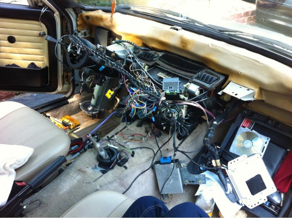

                  Did mine this summer using the DIY he linked above. Tedious & ugly, but not all that hard. Well worth it imo... Set aside a good 8 hours to make sure you can clean up everything while you are in there. A not yet intoxicated friend is good help getting new dash in. Have some new foam ready to seal up the blower/vent inlet; you'll feel better about yourself later. I was far too tired to snap an after picture, but this is the mess you find when you dive in.
