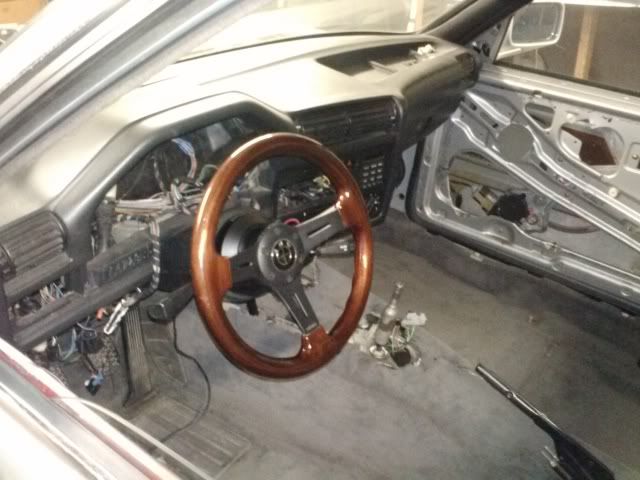

    Post pics if you get it, especially the distance between the wheel and stalks.
