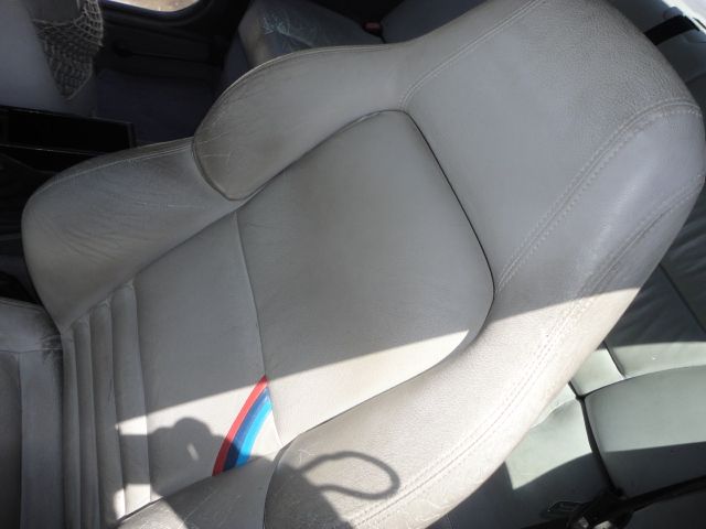

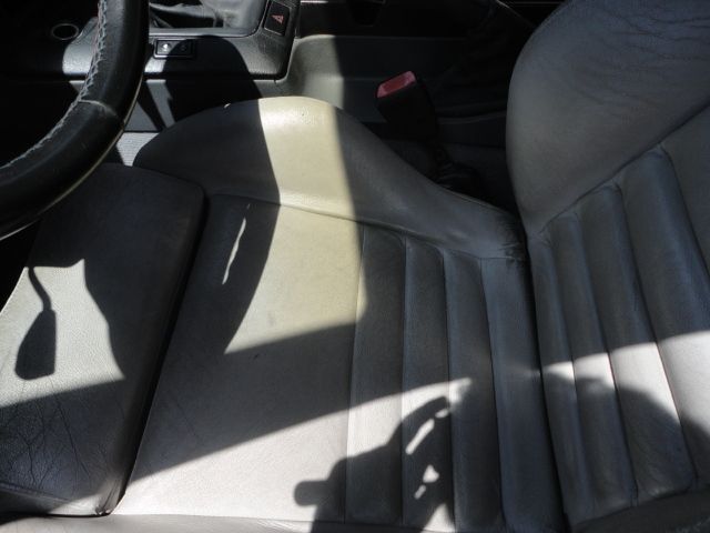

    I just picked up a 95 M3 and I need some help with the interior. The seats have a yellow tint due to being so dirty and I was wondering what product would help?

      For as bad as that is, I would recommend Super Clean/ Purple Power and a scrub brush. I know that sounds really harsh, but I did this in my e34 and they came out great.
      Before:
      After
      Side by side.
      I then cleaned them with Lexol leather cleaner and conditioned them with Lexol conditioner. The cleaner did nothing before I used the super clean.
      DO NOT spray it on the seats. Spray it on the brush. If you spray it on the seat, drips will end up lighter than the rest and and hard to get rid of. After scrubbing a section, I wiped it off with a clean wet rag. Work in small areas and don't let it dry.
