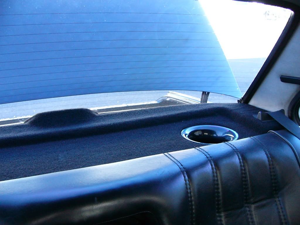

        What I did years ago was what I would consider a flawless re-dye.
        OK, first, the product: http://appliedcolors.com/shop/black-dye-8-oz
        I used it straight out of the bottle in a $10 (told you it was a long time ago) Harbor Freight spray gun.
        I gently scrubbed the seat with a white (finest) scotch-brite and acetone, then wiped it carefully in one direction with clean cloths and acetone, making sure to leave no residue anywhere. I sprayed the black color over the beige everywhere, did 3 or 4 coats, including the armrest, which got more like 10.
        Its been years and it still looks great, can't tell in any way it isn't factory. I had zero flaking at all, have never had any residue on a cleaning rag, shines up really pretty with normal protectants and just generally is perfect. That dye kicks ass IMO. I highly recommend it, assuming the product hasn't changed.
