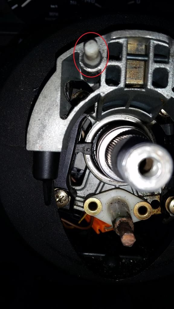

    I replaced my airbag wheel and have all the necessary spacer. Everything work except the wheel hits this "thing". I've search and saw that I have to pull this thing out. If I do this will the turn signal return function still work? Is there a different solution?
    The steering wheels turns fine but it makes a clicking sound everytime it hits this thing that sticks out. Picture show the plastic sticking out because the turn signal is engaged. it goes in a little if the turn signal is not engaged but still hits the wheel. Thanks.

      yes. maybe they are talking about the white plastic sticking out from the top

        not sure if this is the same issue i'm having right now. dont' want to pull the plastic and fugged up my car without confirmation.

          get rid of that white thing at 11 oclock in that picture

            the piece you have circled should stay there, thats the auto-cancel on the turn signals

              okay thanks. get rid of this

                what he said :)
                I push the plastic pin in there, break of a toothpick and shove it in to there so that it stays in its place.

                  good idea just in case the airbag wheel goes back (not that it will) ;D
                  Thanks all

                    I'm having the same issue. I'll see if this solves it as well.

                      problem solved. Thanks again.
