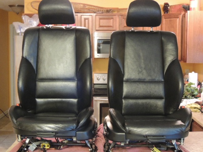

I got these awesome E46 seats to put in my E30! Does anyone know if they're heated?
  • irocz0r
    • Jun 2015
    • 41
    Hey guys, I picked up these seats for a great price locally off Craigslist. They have power adjustments, which is pretty cool. I was reading online I just have to hook up the hot and ground wires and they're ready to rock. I'm also going to get a plug-and-play bracket from Kaduza.
    Does anyone know if these are heated? I don't think they are, but I'm not 100%.

    I just scored the same exact seats at my local pick and pull for $100.00. I couldn't refuse such a good deal.
    If you haven't already figured it out yourself, there is a small connector with two wires running into it, red and brown, that plugs into the back of the larger yellow connector. Unplug this connector and now you can power the seats (red = 12 volt power, brown = ground) from an external power source. Even the lumbar pump on mine works. The only other connection that will need figuring out is the seatbelt warning wires.
    If you are missing the original seat rail covers the part numbers are:
    52108226431
    52108226432
    Have you seen these custom mounts by Kadunza or are you making your own?
