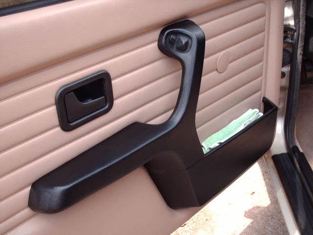

          No, you just take your time and do a good job and it'll look real nice.
          I did these on my car with some Black Vinyl/Fabric Paint from the store. Prepped the armrests with a Mr. Clean Magic Eraser and some rubbing alcohol and then applied about 5 very light coats. Letting each dry in between.
