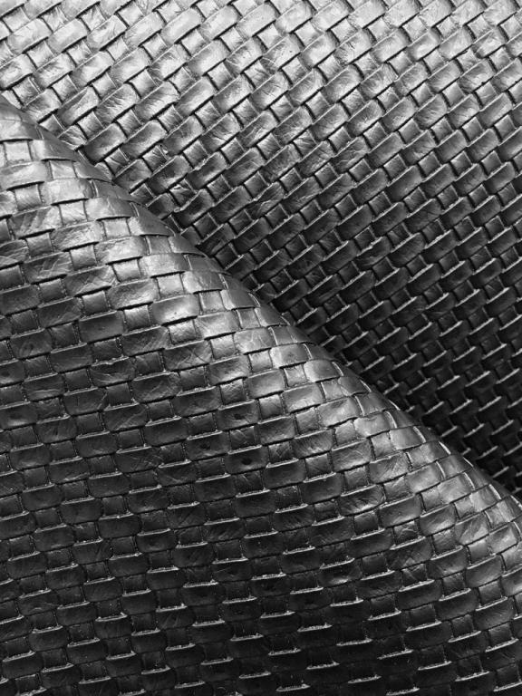

                        I too have loved the interior on the Singer Porches and I am doing this to an E30.
                        My LONG term project, 5-speed swap needs completion first, will be a custom all black interior in my already all black interior 325iX. I have already purchased the basket weave material. The plan is to cover the center section of the sport seats with the basket weave material as well as custom made center sections for the door panels covered in the same material. Singer Porsches is where I got my inspiration.
                        The basket weave material in the Singer Porsches is leather I would imagine and though I did find the "real deal" leather basket weave it was way out of my price range and probably a bit too "fancy" for my iX. With this being said, I went with a faux leather vinyl with the "look" of a true basket weave. I am very happy with the thickness of the Ebay material.
                        Again, this will be a long term project and I will have to engage the local auto upholstery shop to see if they are willing to use my supplied material.
                        The floors will remain carpeted.
                        https://www.ebay.com/itm/Black-Baske...-/151975903669
