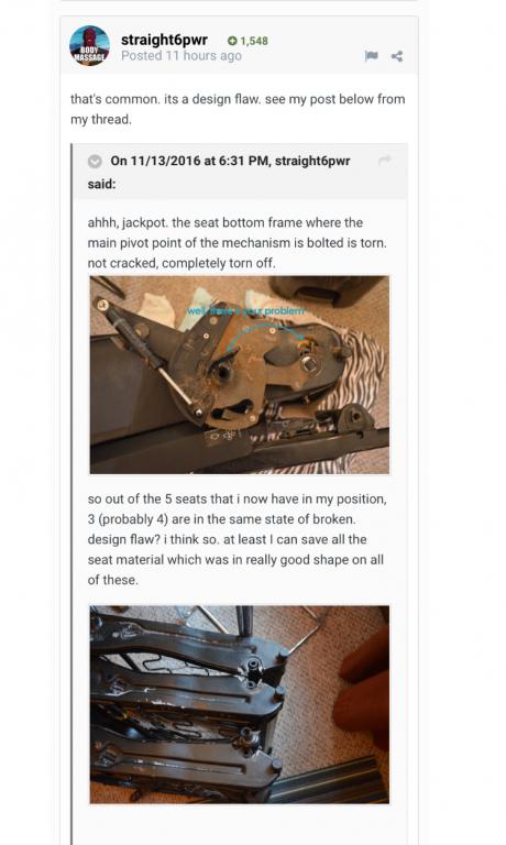

    Basically drivers seat, when you pull up on the handle (door side of seat) to let you recline the locking mechanism doesn't seem to be moving far enough on the other side (counsel side of the seat) to unlock that side so the seat doesn't move (mgromero's thread has a great picture). All the shocks are strong, the tabs aren't broken. Any thoughts on if this can be fixed? Looks like audiquattrot replaced the seat bottom (so the "bar" that connects the right and left mechanism seemed to be a problem?

    So for anyone else that comes across this, in my case I believe the reason this is happening is that the side of the seat frame where the bar that runs through the seat is housed and connects to the mechanism has cracked and moved substantially. I'm either going to get another seat bottom like others or I'll see if it can get it back to correct position and weld it back.
    In order to find this I had to take the entire seat bottom apart down to bare wire frame.

        Thanks for the response but the pins aren’t my problem. Seat frame cracked and the transfer bar or whatever it’s real name is that transfer the motion from the mechanism with the handle to the other side is out of place. Seat beads to be rewelded or replaced. There’s a great photo from another user I’ll try to find and share
