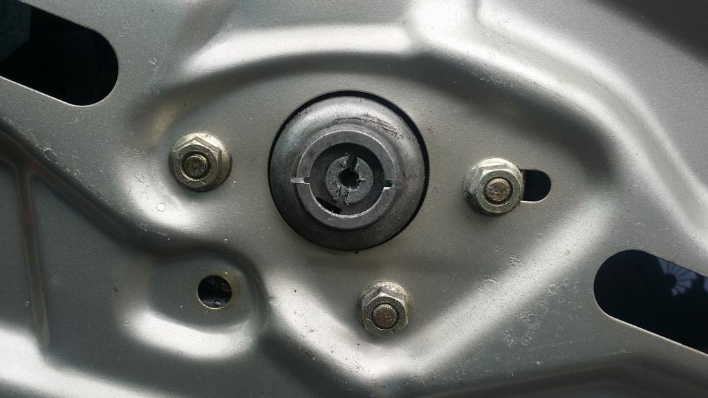

    Before reinstalling the door panels, we rolled them both up manually via the allen bolt but the passenger side put up such a huge fight that it stripped the allen hole while she was cranking it. It was late on a Sunday night so I had the GF throw the door panels back on and I packing taped the crack at the top of the window. Fast forward to next weekend and she pulled the door panels back off starting on the passenger side. Low and behold she missed reconnecting the plugs together, but even after plugging them in, the window still won't operate via the button. I cut a flathead notch where the allen had stripped, but it's still a fight to roll the windows up or down and I have to push the glass from the bottom while manually turning a screwdriver to get the window to close fully. At this point I decided to jumper the motor with everything installed in the car.

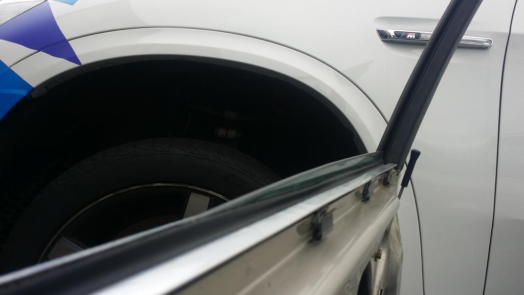

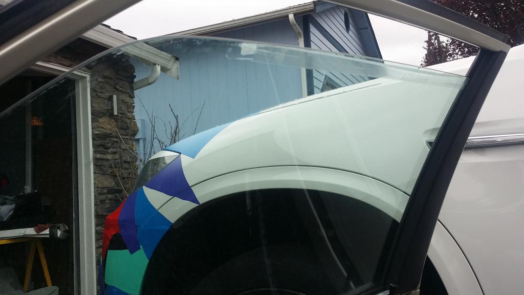

    Mind you I've only tested the passenger side jumpered to a battery this way, I've yet to have her repull the drivers panel and jumper it. On top of all this, both windows only roll down this far vs going flush with the window seals.
