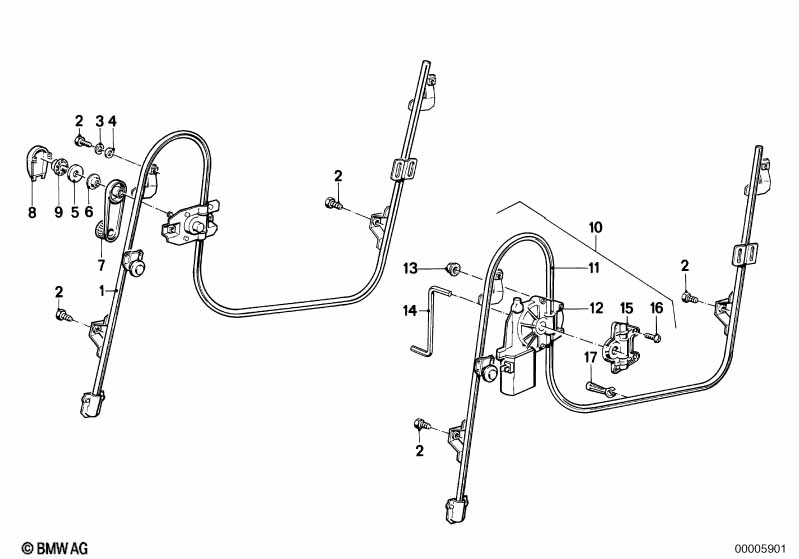

    Early Model Coupe Manual Window Conversion ?s
    1. I know that the regulators don't save weight
    2. The harness connection is completely fucked on my 3/87 325is, so I don't want to focus on fixing that
    3. I want to go completely harness-less in my 325is because it's track prepped (still streetable).
    4. Am I really reading this correctly, there's no regulator but this weird cable looking thing?
  • roguetoaster
    Biggus Tippus
    • 7830
    It's some sort of crazy cable contraption, but it seems to work.
    • KI4UJO
      • Jun 2011
      • 641
      You're correct, there is no traditional regulator. The cable-style mechanism is actually very easy to deal with.
      I did this years ago in my 24v early model, it's a direct swap minus I believe needing two extra M6 bolts per side. Only recommendation is to shoot some sort of lube into the manual regulator (assuming you got them used) before installing.

        • paynemw
          • Dec 2015
          • 439
          Closing this out, the early coupe window regulators are direct bolt in for early model electronic window regulators. The window glass is the same between early model electronic and manual glass are the same. HOWEVER, later model window regulators and window glass are NOT interchangeable with early model regulator parts. I have read that late model window regulators might be able to go into early model doors, but I do not have information about that. I ended up putting manual window regulators in my early 325iS and I love it! I removed the door harnesses all the way back to the junction.
