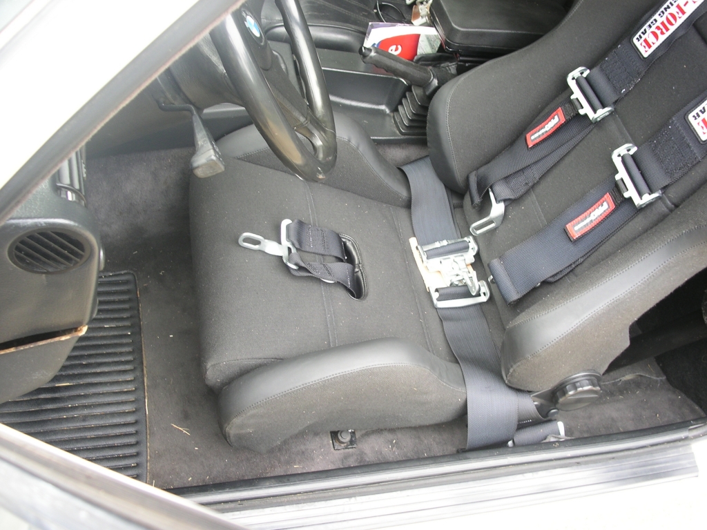

      I wasn't so lucky to have two seats in good condition, so I took one bolster off the ratty seat (the slider with teh seat belt clip), and put in the place of the other slider. So now one seat have two seat-belt clips, and all you have to do is remove the extra seat-belt clip, and your're good to go. The set-up doesn't look too bad, but it was a nice temporary fix.

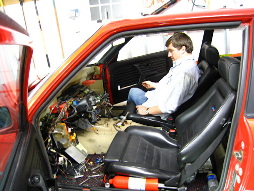

            I did this bracket for Ely's seat I made him. You can see I cut the ends off the sliders then welded new extending tabs, this moves the sliders to the insides of the holes in the floor pan. Then Ely used 2 pieces of plate steel and mounted them on to the bottom of the seats. He drilled new holes in the plate steel and then mounted them to the sliders. PM Ely if you want details. Rs4Pro3

              i can vouch for the above seat very nicely done. seen it in person many times.

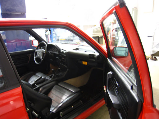

                            I have these in the car.
                            I'm told they are e21 recaro's adapted from factory to fit the first e30's.
                            Not sure if it's true, but they fit without brackets and are extremely similar (if not the same) to the e21 recaro's.

                              I have these too, was sold under the impression of them being from e30 320i euro car. Rear seat came with factory head rests and padded with springs in the rear instead of foam.
