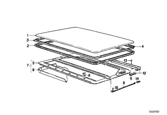

        Another thing - anyone replace the seal around the sun/moon roof? I am speaking of the mouse fur type sear that is around the roof.

          its really easy to change the seals. very expensive too. get them, they are worth it

            wonder if it uses the standard roof seals...

              i heard for the glass roofs that the seals are NLA. I could be mistaken though.

                    I pulled out the stock metal roof today, and compared the seal on the glass roof. It is 100% exactly the same. I am going to get the part number, and then I will post it here.

                      02 Circul.sliding/lifting Roof Cover Gasket L=2580mm 1 54121903725 $114.95
                      03 Front Sliding/lifting Roof Cover Gasket L=930mm 1 54128106928 $61.10
                      04 Rear Sliding/lifting Roof Cover Gasket L=1650mm 1 54121906999 $89.00
                      Real OEM prices are always wrong. But I think I would only need the lower two parts. #1 I do not think I will need. I will have to check it out.

                        Bav prices...
                        Sunroof Seal - Front - Short
                        Part # : 54 12 8 106 928 $ 49.95
                        Sunroof Seal - Rear Long
                        Part # : 54 12 1 906 999 $ 79.95
                        I might PM my friend Blunt and check the cock and ball pricing.

                          The one on mine is one peice all the way around... Hmm?

                            I thought mine was too - but I looked real close and began taking it off. Do you have any markings in your glass roof? (brand)

                              it doesnt matter which you use i dont think. a seal is a seal as long as its all the way around
