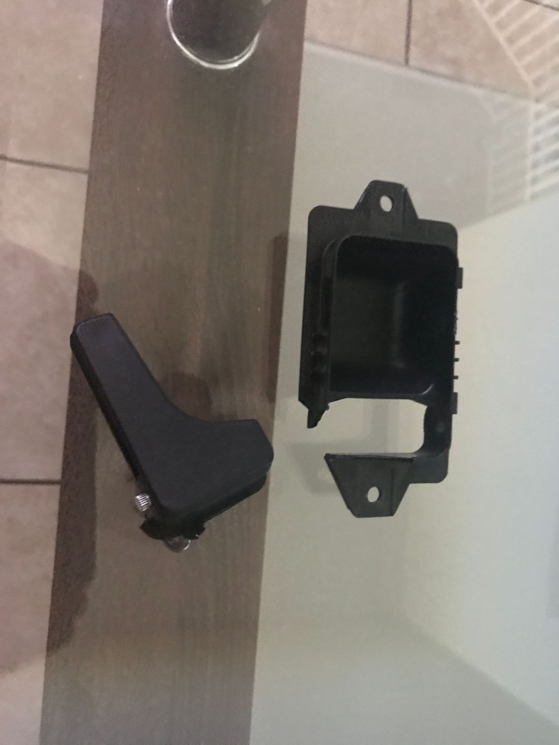

    Thank you guys for the tips! I was just able to do this possibly even quicker and easier.
    (I bought my car with the lever floating around inside the panel, but i could still crank it and use the top how i wanted. Then it started knocking around somethin' fierce.)
    Since my housing was pulverized and not my lever, which seems to be the norm, i just slid out the pin and reused the lever in the new housing. No caps, no screws, no stuff falling into car. I did remove the panel to reach down from the top.
    What i didn't do is recover the bulk of the old housing LOL! i thought i reached where it would have fallen but now i realize that it is probably dangling on the cables somewhere (still knocking around).
    d'oh
