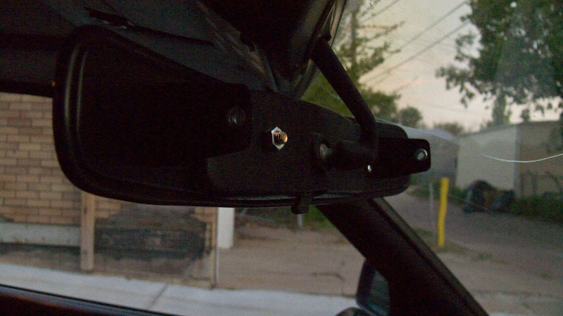

    Hey guys, i have had my allview mirror for about 7-8 months and never mounted it.
    For those of you that have mounted it can you show/tell how it was mounted.
    Mine is set up at the moment to install it on a cage, I am not going that route for a nother year or so, so id like to find another way.
    On the back it looks like i can screw in a holding (arm) to it. anyone know where to get the arm to screw in?

    I did this with a longacre, but should work for yours too. Simply took an old non-maplight mirror, drilled some holes in it, removed the glass from the new mirror, put some holes through it, couple bolts, bit of rubber between the two to keep vibrations down a bit and you're set. Very easy to go back to a 'normal' mirror again, but I find it to be very useful driving in traffic with a bunch of idiots.
