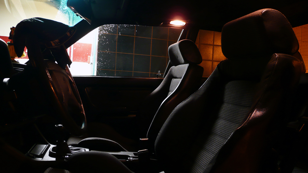

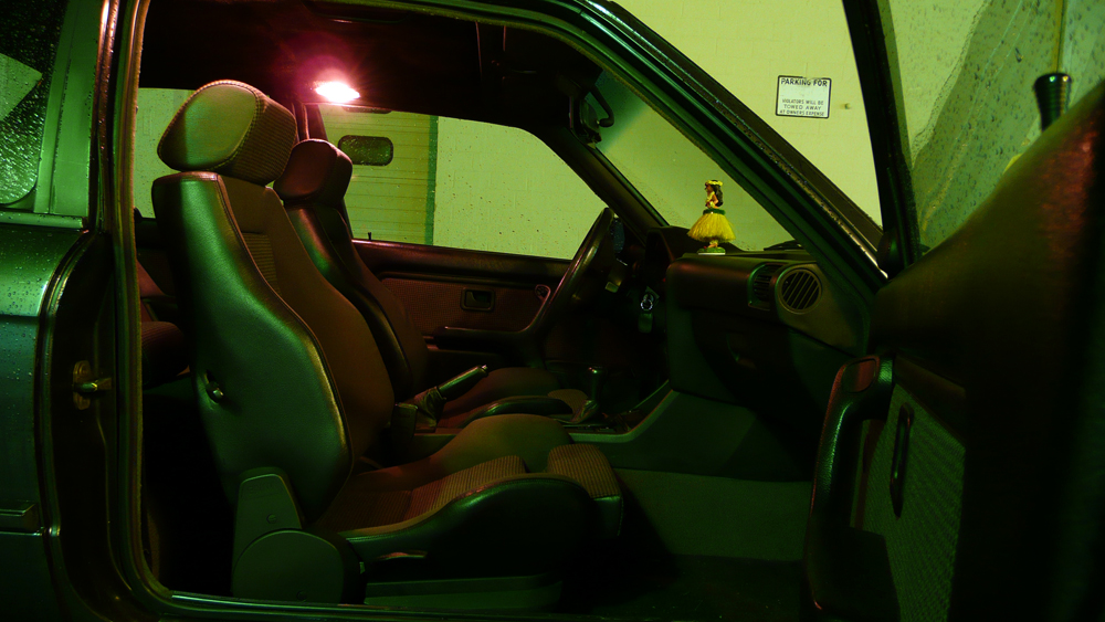

                      EDIT: One had a bent frame, the other had busted cables, and they could use new shocks. Still have to swap out the seatbelt catchers too. <3 these seats!!

                        ^whoa

                          WOW, yours look burly as hell. Bolsters look healthier than mine :D
                          Congrats on the find.
